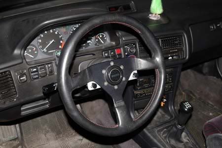

Here’s my GSR with a Momo Monte Carlo wheel (sorry the cockpit’s a mess).
Check the second photo and compare the gap between the turn-signal stalk and the back of the wheel. I don’t think it is substantially different from that of stock.

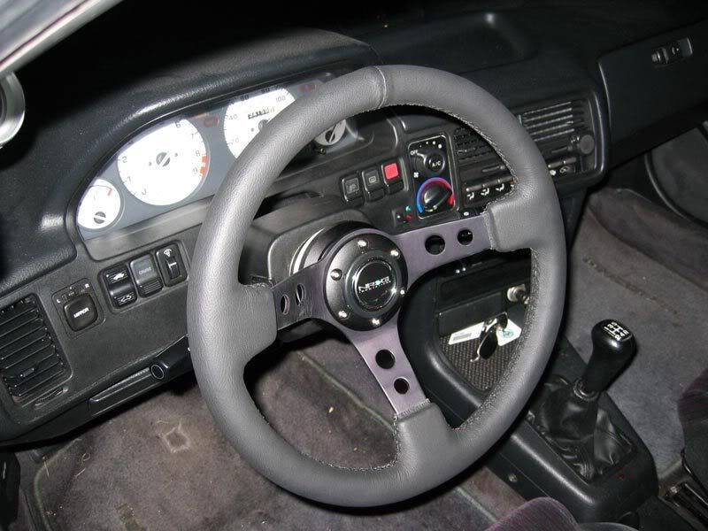

Here’s another messy GSR cockpit. I’ve got the NRG short hub and deepdish wheel, and it fits perfectly. If you get a regular flat wheel, make sure you get a longer hub or quick-release, or you’ll have to add spacers like Tokabowla did.

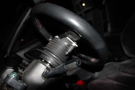

Here’s how the wheel looks. I had to MacGyver a new spring contact inorder for the horn to work.
Notice the how the distance from the steering wheel to the turn signal stalk is very much like stock.

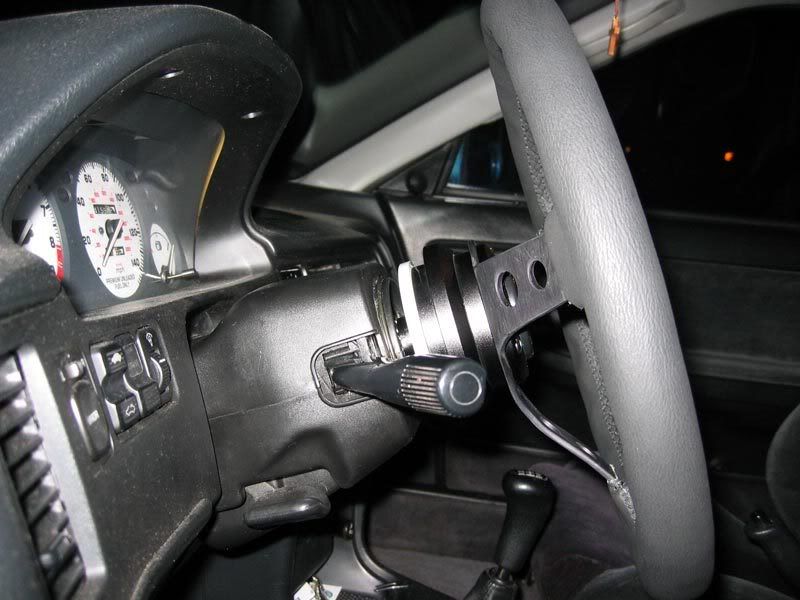

NRG Short hub with NRG Gen2 Quick Release… This is with a cheap ebay steering wheel.

that’s WAY far forward man. Too much for my taste.

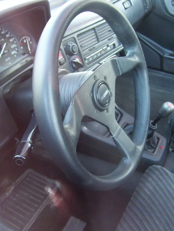

momo monte carlo with momo hub. feels just like stock distance
