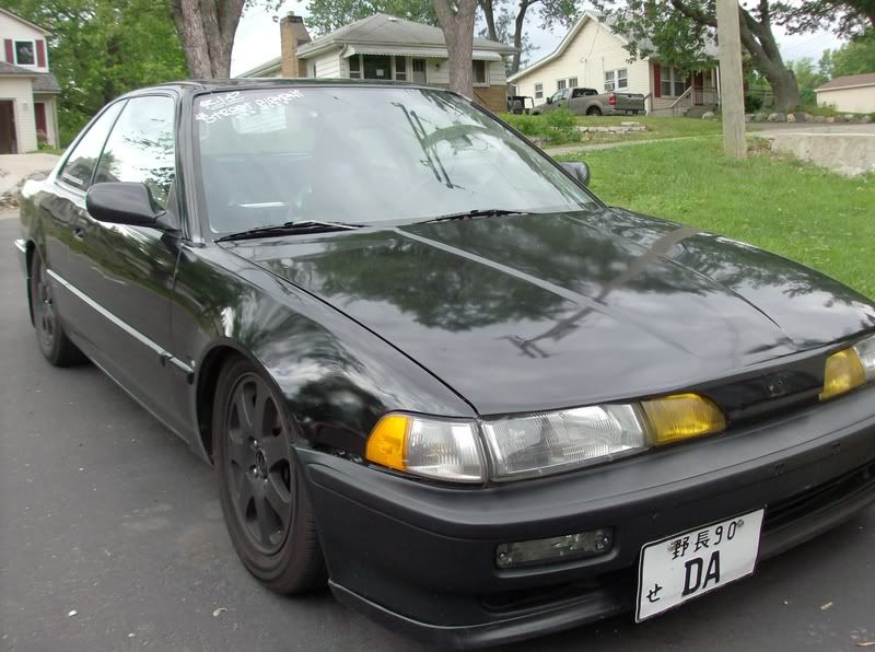

here you go i hope this helps . lower with tein springs
