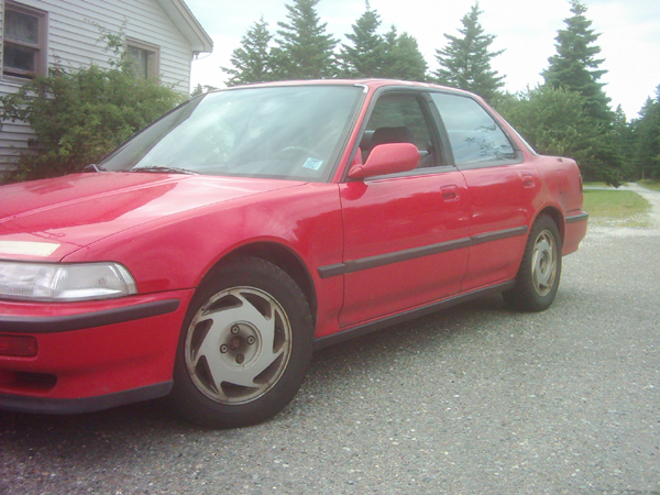

I actually got some free time this weekend and I finished up the 2nd side skirt and installed them on my DB1. I remembered to take pics along the way, so here ya go ![]()
First off, I ran a piece of masking tape along the top lip of the skirt to give myself a line to cut along.
Then I just slowly cut along the tape line with a dremel fiberglass re-inforced cutting wheel.
You also have to cut off the brackets from the inside. You can see 2 of these brackets below.
I then flipped it over and ran a tape line along the bottom of the skirt (it’s too long that way). In this pic I cut it a little short. I cut the other skirt perfect. Best place is about a 3/4 inch AFTER the stock screw holes (instead of right acros them like the pic).
Here’s what it looks like when it’s done and sanded smooth. Like I said, leave a little more then I did in this one (it still works… but about 3/4" longer is perfect!)
Here’s what the other side looks like. This is the BEST way to cut it. This fit perfectly!! You can also see the screws I pre-drilled into the skirt to make it easy to install under the car.
We then jack the car up and screwed it into the rocker panel with 3/4" stainless steel self tapping screws. I put a screw where every stock screw hole was, but I put it right through the skirt (not through the hole).
Here’s what the first finished side looked like… perfect fit. Just repeated the same process on the passenger side.
Here’s the finished product. I think it looks great!
It lines up a LOT better then I thought it would with the front lip. It’s perfect. It needs a rear lip badly though. Thanks for looking! I hope this helps some people out!!!
