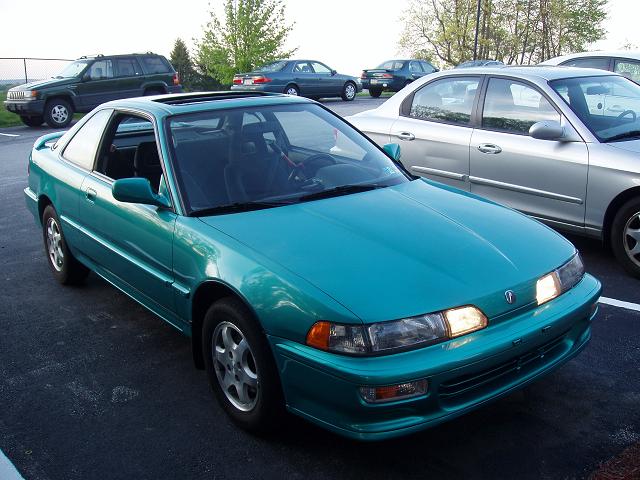

Here’s my rewired fogs, and yes youcan use a screwdriver to prythe switches off. The easiest way though is to pop off the defogger then simply push the fog switch out from the back with your fingers.
