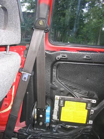

You WILL need to have some kinda of plates with the nut welded to it to mount the seatbelt brackets to the floor/body. What I did for my CDN seatbelts was got some 2.5-3" thick washers, high grade nuts. And the nuts fit perfectly into the holes of the washers I recall, or we drilled them out. Then we welded the nut flush to the washer. Drilled holes in the floor so the nut was recessed into the hole. Then welded the washer to the body. That left us with a flush mounting point, not a nut sticking up. For the pillar mount, we weled the nut/washer to the piller but with the nut sticking out. Also tapped the existing hole after we welded the new one up so there was extra threads.

sorry I didn’t get any pics when we installed them and I have my interior in and don’t plan on taking anything out anytime soon to get pics. sorry.

92 civic guys with dc dash conversions do it. there are a couple threads on h-t with actual pix.
that should give you a decent idea…
