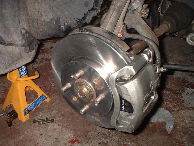

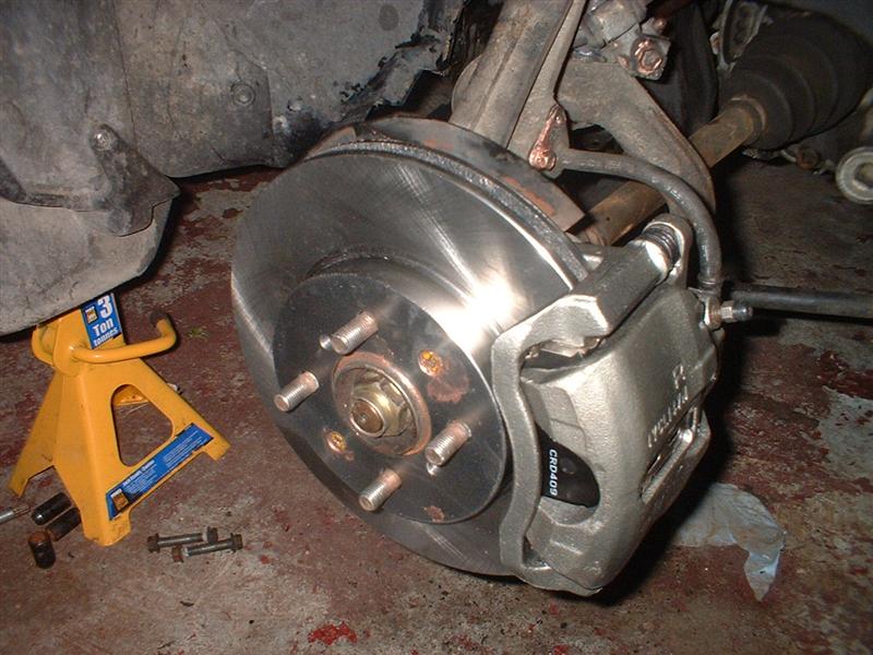

I had other problems as well with seized/leaky calipers and leaky brake lines so I ended up rebuilding all four calipers myself, replacing all pads and rotors but the sponge was still there. Then I found the “brake disaster” thread, followed the Tegger DIY located here http://www.tegger.com/hondafaq/mastercylinderreplace/adjustment.html and voila! brakes are amazing. No sponge, no sink, they just feel brand new.

Thanks cdccivic. It does feel good to get it done after all that time. I just about gave up so many times and brought it to a shop but I just couldn’t bring myself to do it. I have been able to figure out every problem I have ever had with my integra (thanks to G2IC) so far, I wasn’t gonna let it beat me this time. :wink:

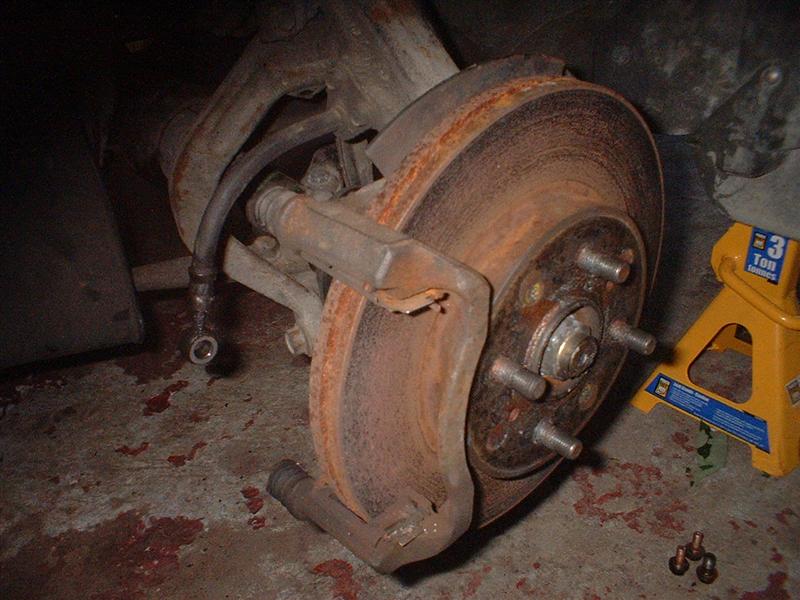

Forgot to take the before pic with the caliper on but, I’m sure you guys can imagine what it looked like judging by the state of the rotor and bracket. A rusty, leaky, brake fluid covered mess!

[QUOTE=Zenmachine;2225957]Thanks cdccivic. It does feel good to get it done after all that time. I just about gave up so many times and brought it to a shop but I just couldn’t bring myself to do it. I have been able to figure out every problem I have ever had with my integra (thanks to G2IC) so far, I wasn’t gonna let it beat me this time. :wink:
Forgot to take the before pic with the caliper on but, I’m sure you guys can imagine what it looked like judging by the state of the rotor and bracket. A rusty, leaky, brake fluid covered mess![/QUOTE]
Ive been in that boat in 3 different Hondas lol…so I am glad you didnt give in. :slight_smile:
