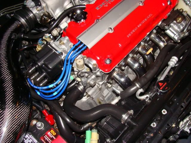

Here’s my engine bay…
Interior pics pending…
What kinda intake is that?
In another thread mi_da_dc_eg wanted pictures of my engine bay… so here you go.
Nothing special its not shaved just tucked and cleaned up a bit…
You said you had some questions? Please feel free to ask.
I do plan on building a ghost engine harness but thats not for awhile more than likely.
