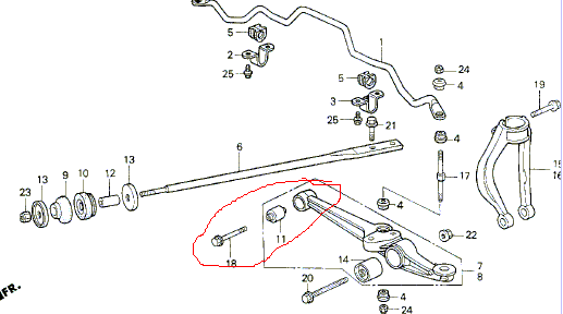

my lower control arm bolt to the power steering rack wont come out. the bolt is stuck in the inner metal sleeve. when i was unscrewing the bolt the inner sleeve came with it and bent the bracket. i’ve tried vice grips, beating with a sledge hammer and a saw zaw. the inner metal was so smooth the saw zaw kept cutting into the bracket. the vice grips can’t hold the sleeve no matter how hard i tighten it. the hammer didn’t break anything loose. i was beginning to wonder if the bolt was supposed to come out of the sleeve at all?
umm? Do you have a picture, your power steering rack should be connected the to the knuckles by a tie bar, never touching your lca. Your lca is then bolted to the frame, strut fork, caster rod, and sway bar if I remember right, so I dont know which bushing you are talking about. Is your underbody badly oxidized?
im guessing its the frame but it looks like a rack the power steering rack bolts up to as well. its the last bolt on the lca

on the right side on your first pic the bolt youre trying to get out threads into a nut thats welded to the bracket. when i tried to back my bolt out it stripped that entire nut. i had to cut the bolt out using a combiation of a sawzall, chisels, and air tools. i nicked the bracket in one spot a little, but i cant see it being a problem. then i had to chisel that welded nut off. and now im gonna put a new nut on there and put some JB weld between the nut and the frame, sine i cant weld it yet. one of the guys at First State Moto assured me that path i took was not a problem and even said that JB welding it wasnt needed, if i use high strength threadlocker, and torque it to spec, that itll hold just as well.

EDIT- the problem is, the center shaft of that bolt has ridges running down it, the sleeve does not. but when rust forms on the inside ofthe sleeves, between the grooves on the bolt, it keeps it from spinning. when i took mine out the bolt fit back in the sleeve like a “key” if u know wut mean.
I had the same exact problem on the same bolt. I just cut both ends of the bolt off and bought a new bolt.

Wow. Im glad im not the only one that had a problem with the LCA bolt going to the rear cross member.
I fixed mine by dropping the rear cross member “looping the lines on the p/s rack” and used my plasma cutter to cut a chunk of the rear cross member off and bought another one off ebay for 55 bucks shipped.
