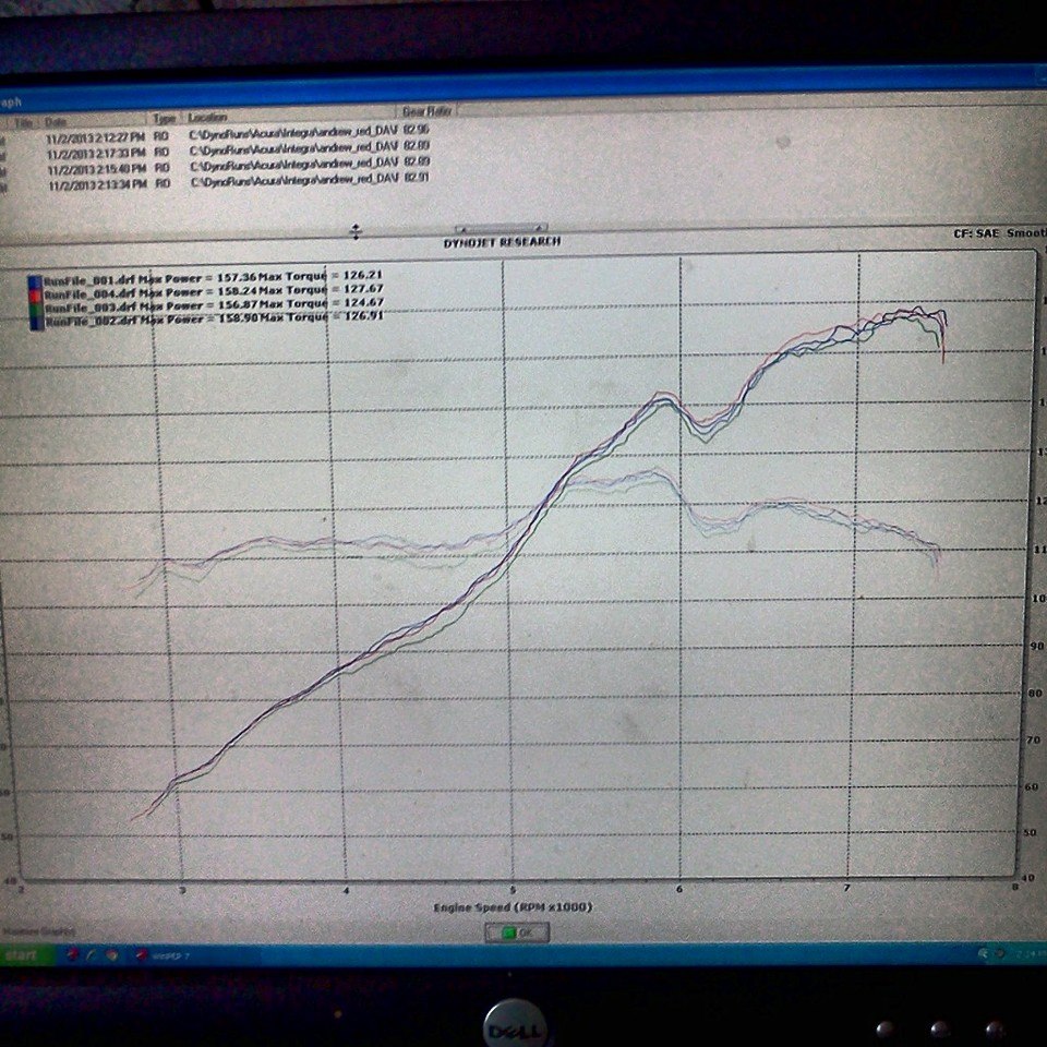

Here’s my B18A1 build I had before she decided to drop a valve on me earlier today.
91 B18A1 block 81mm
92 head
Injen SRI
3in Velocity Stack
68mm TB
Skunk2 IM
P2R Thermal Gaskets
Hytech rep header
2.5in test pipe
2.5in cat-back
Crower 402s
Skunk2 Gen1 valvesprings
PR3 pistons
Adjustable FPR
Dam almost 160 whp on crower 402s! That’s pretty good . I have the exact same build as you except I went with crower 404s and a Kms dual valve springs . 4 miles into the build I hit piston to valve due to the t belt snapping. I can’t figure out if i tentioned my t belt to tight or the Kms springs weren’t stiff enough . Anyways I replaced 6 valves put it back together and iv been running on stock cams ever since . Iv been thinking about getting 402s . Sorry you dropped a valve man . Good luck
