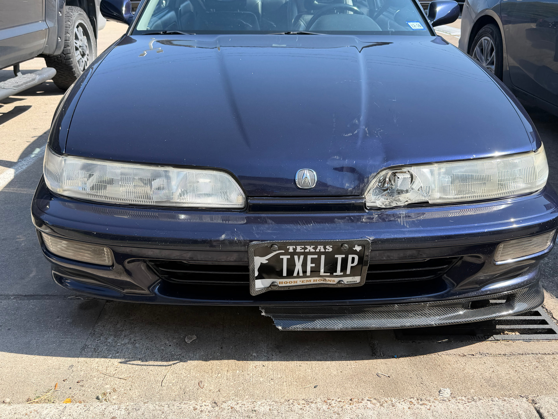

I hit a tire that was kicked up by the truck in front of me. I’ll be working on getting this fixed.
The worst, man. I had a tread get kicked up into my WRX a few months back, thankfully didn’t mess up the paint but it did scuff my headlight pretty good. Better than a fender though.

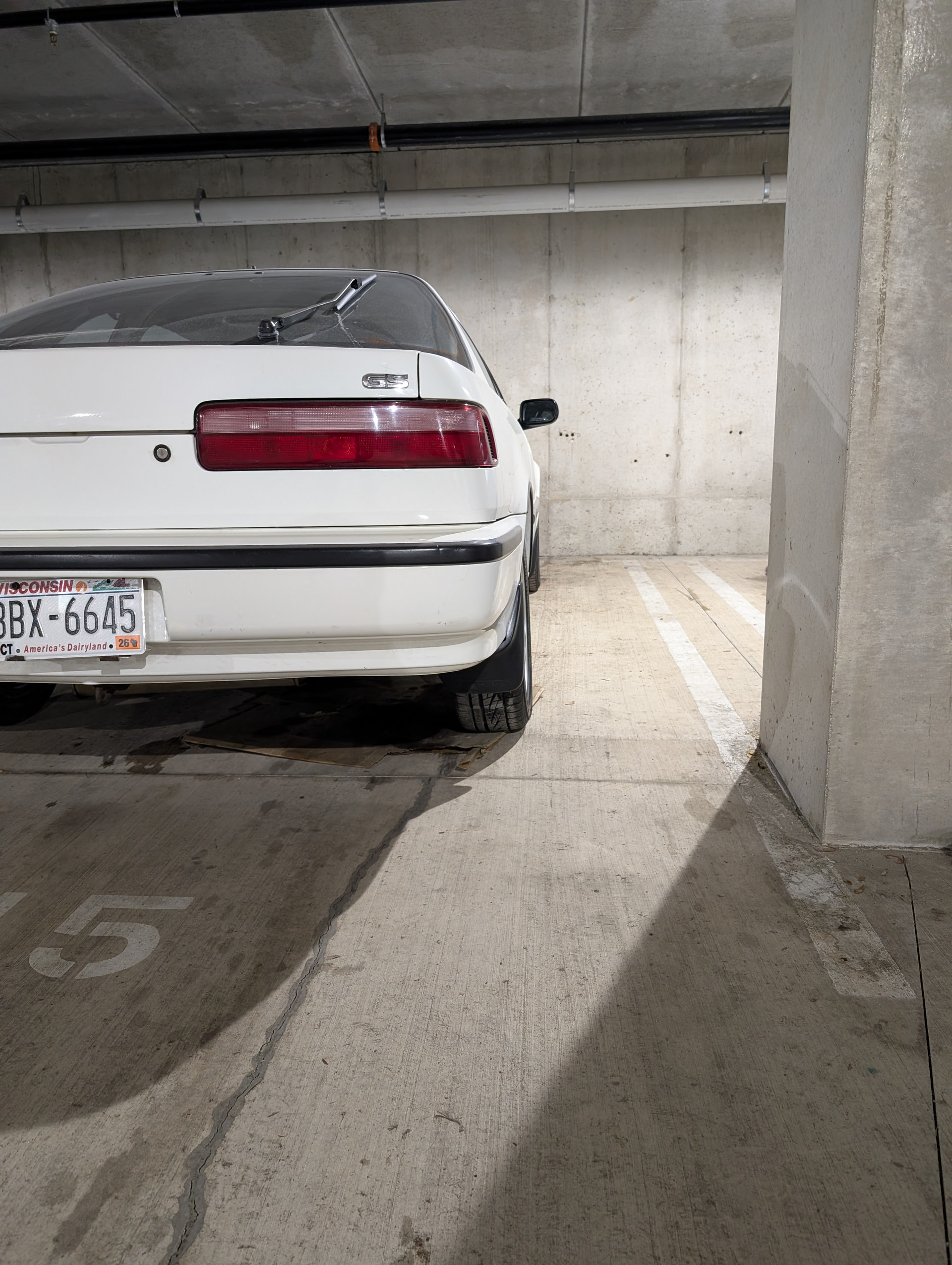

Also, what in the camber gang is going on here???
We all know you wanna be “stanced” :smirking_face:
Maybe if I was trying to tuck 225’s lol
My camber is pretty bad too but amazingly I haven’t seen much issue with tire wear running 195/55/15s. I had to remove the camber kit a while back. Because of that, it’s low on the to-do list.
Thinking about what could be causing this, it’s probably my rear LCAs. The bushings are blown out. I might end up buying some DC arms and bolting them up, and if the cheapo Dorman bushings fail, I’ll just replace them with hardrace when the time comes. For like $96 total for both arms, it’s worth it in my opinion. Especially after the price to replace the bushings on my front LCAs…
There are also some theoretical advantages to the DC rear lower control arms, due to the shock mounting point being 3/4” further towards the wheel compared to a DA. This effectively increases the rear shock lever advantage (stiffer response) and may also lower the rear a tiny bit. Honestly probably not noticeable amounts on either of those. The biggest advantage is that these exist, where DA replacements do not!

I sourced new headlights, ordered another front lip, my body shop is suggesting I source a hood.
Where can you get a front lip?
