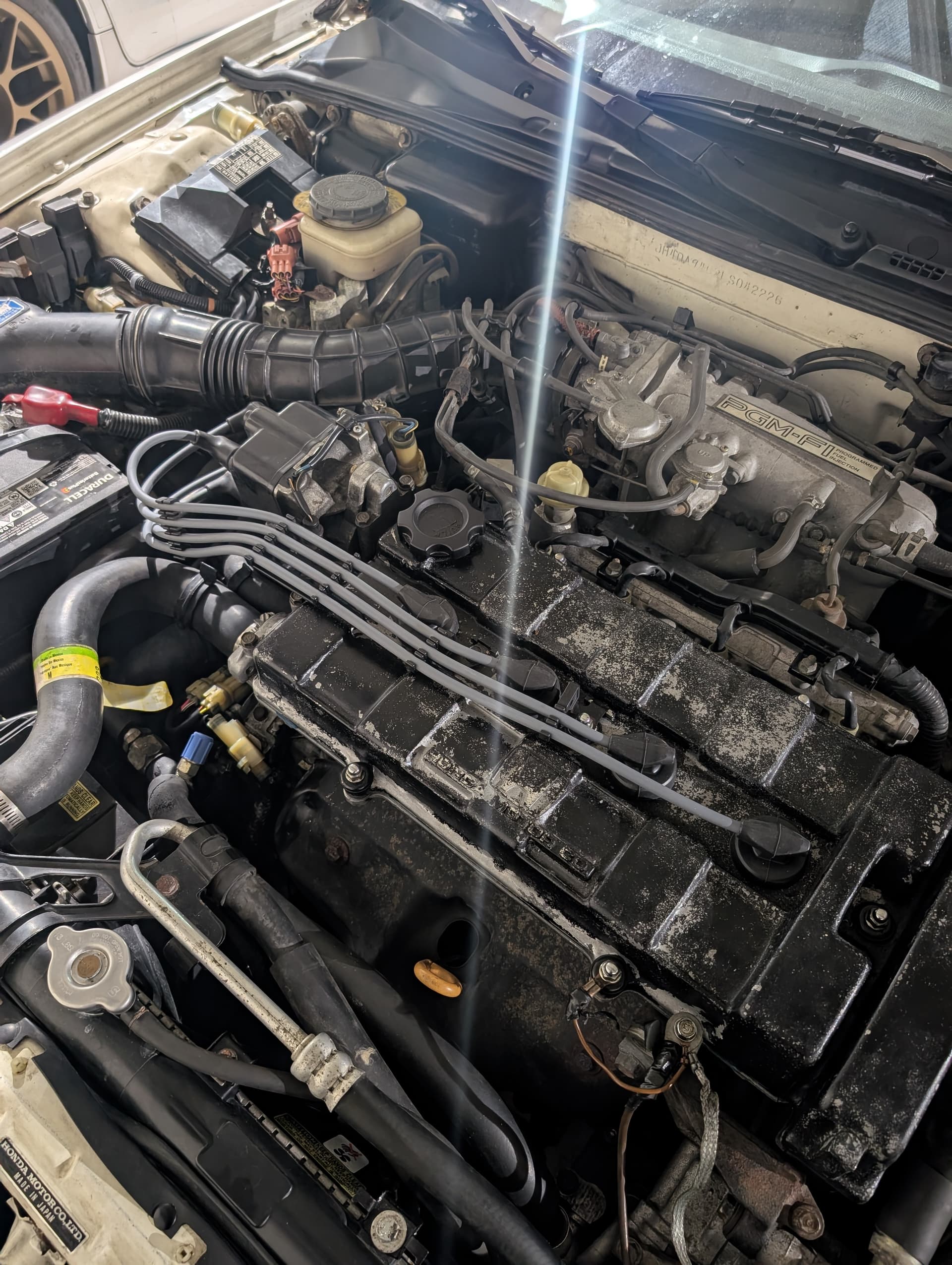

I think I’ve fixed the misfire. New plug wires seem to have done the trick. I think the old ones would get worse once they heated up. The CEL works but when I jumped the code plug it didn’t flash so it didn’t have any codes.

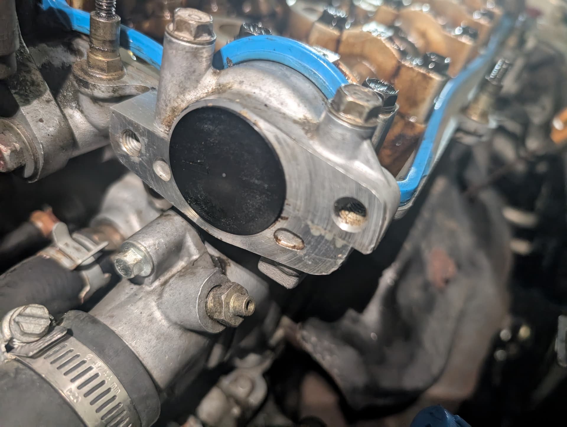

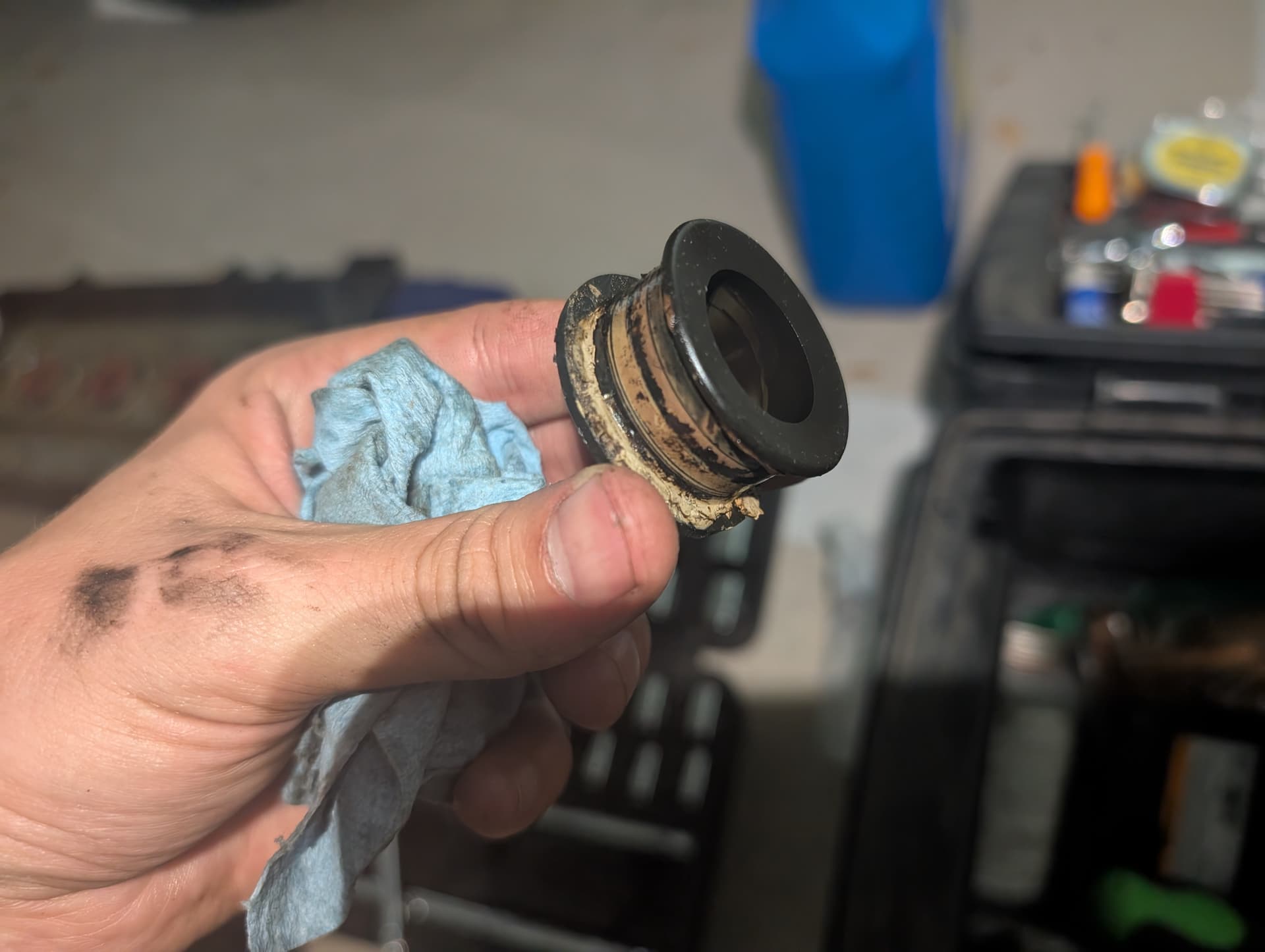

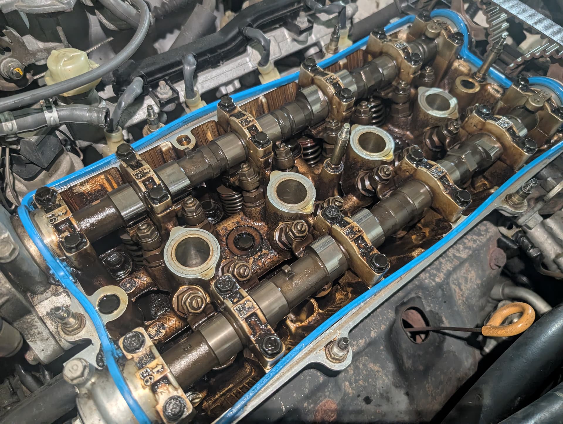

I also fixed the huge oil leak coming from the cam plug. Replaced the old one with the newer DC style plug that has an o-ring and just pushes on. The engine has a thin layer of sludge in the head but what can you expect for an elderly couple and 220k miles? The lobes all look good but it could probably use a valve adjustment.
Gross gooped up old plug:
New hotness:
Head shot:

i think that might be where my leak is coming from. i changed the distributor o ring but there is still wetness so it must be leaking else wear. where did you get that part
from?
Oh. dude. If that isn’t the sole source of your leak, it’s at least a main contributor, and that plug leaks way more than you would think. I got mine off amazon and it seems to be legit, here’s the seller: Amazon.com: Genuine Honda 12513-P72-003 Cylinder Head Plug : Automotive
Keep in mind this will require you to remove your valve cover and the end cam cap. Should not be a problem, just remember to torque the four bolts in a star pattern, torque is 7.2 ft lbs. And install the new plug after you reinstall the cam cap.
And make sure you wipe out all the Hondabond and crap they gooped in the aluminum bits before you pop in the new plug.
ugh thats what i was afraid of. i replaced that valve cover gasket like a year ago when i did a valve adjustment and it was such a pain scraping off all the old honda bond. i was so paranoid about getting alittle bit in the engine.. shouldve replaced them then.
oh well i guess i could just replace the gasket again.
well i guess i dont have to replace the valve cover gasket since last time the valve cover gasket was so old it tore to pieces. i could probably reuse the newer one
Looks like you have the blue one like me, it will probably be able to be reused no problem. I only lifted the corner where the cam cap was, left the other three corners in place and carefully seated the valve cover back on making sure the gasket was going back into the channel nicely.

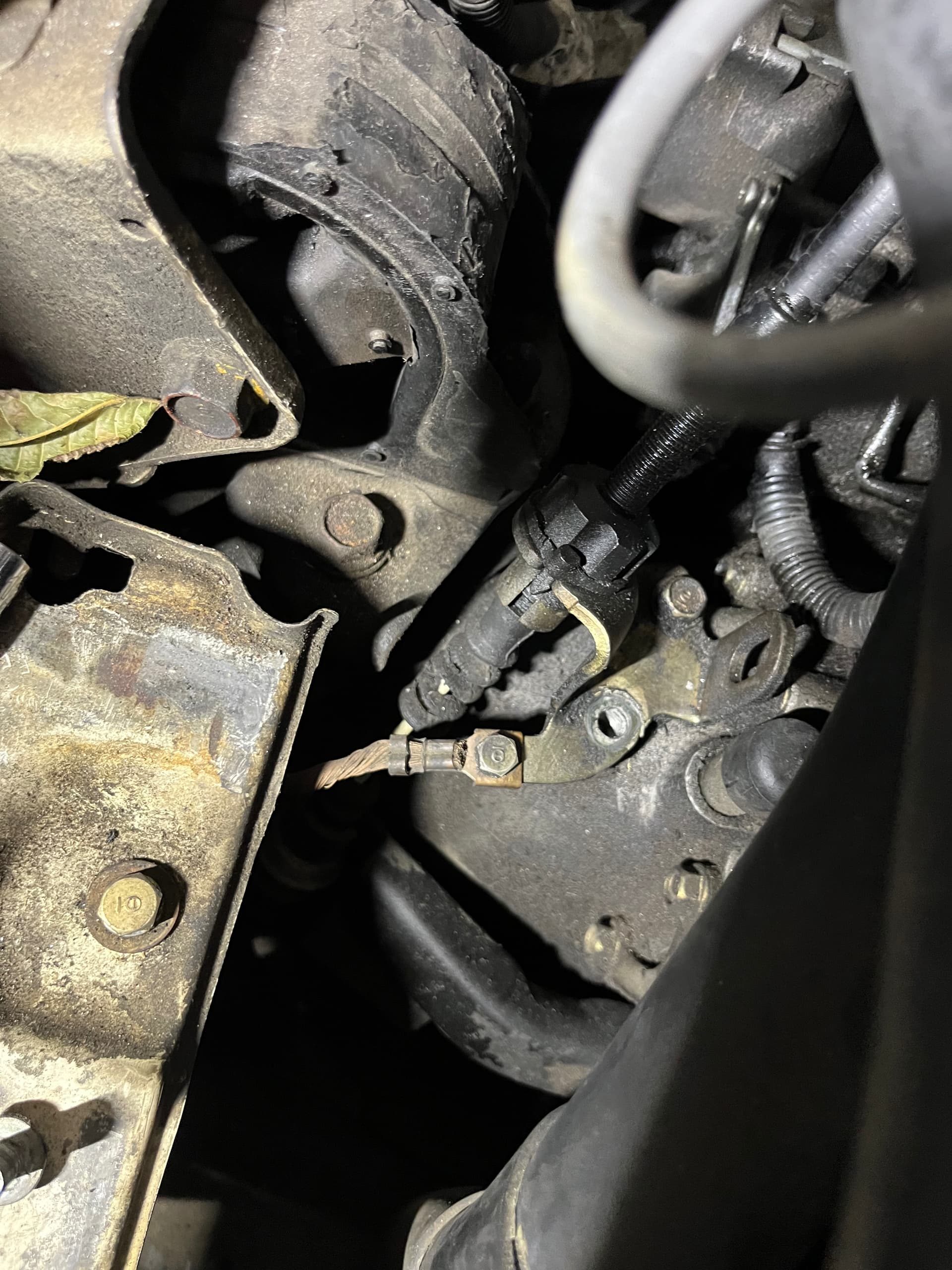

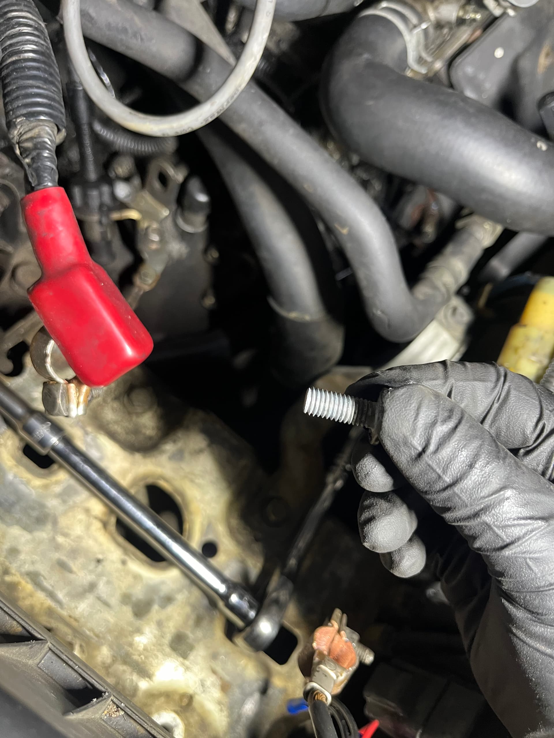

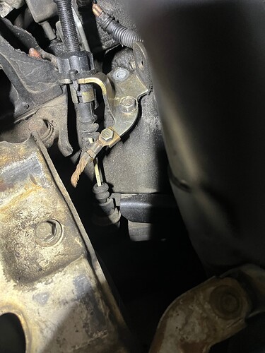

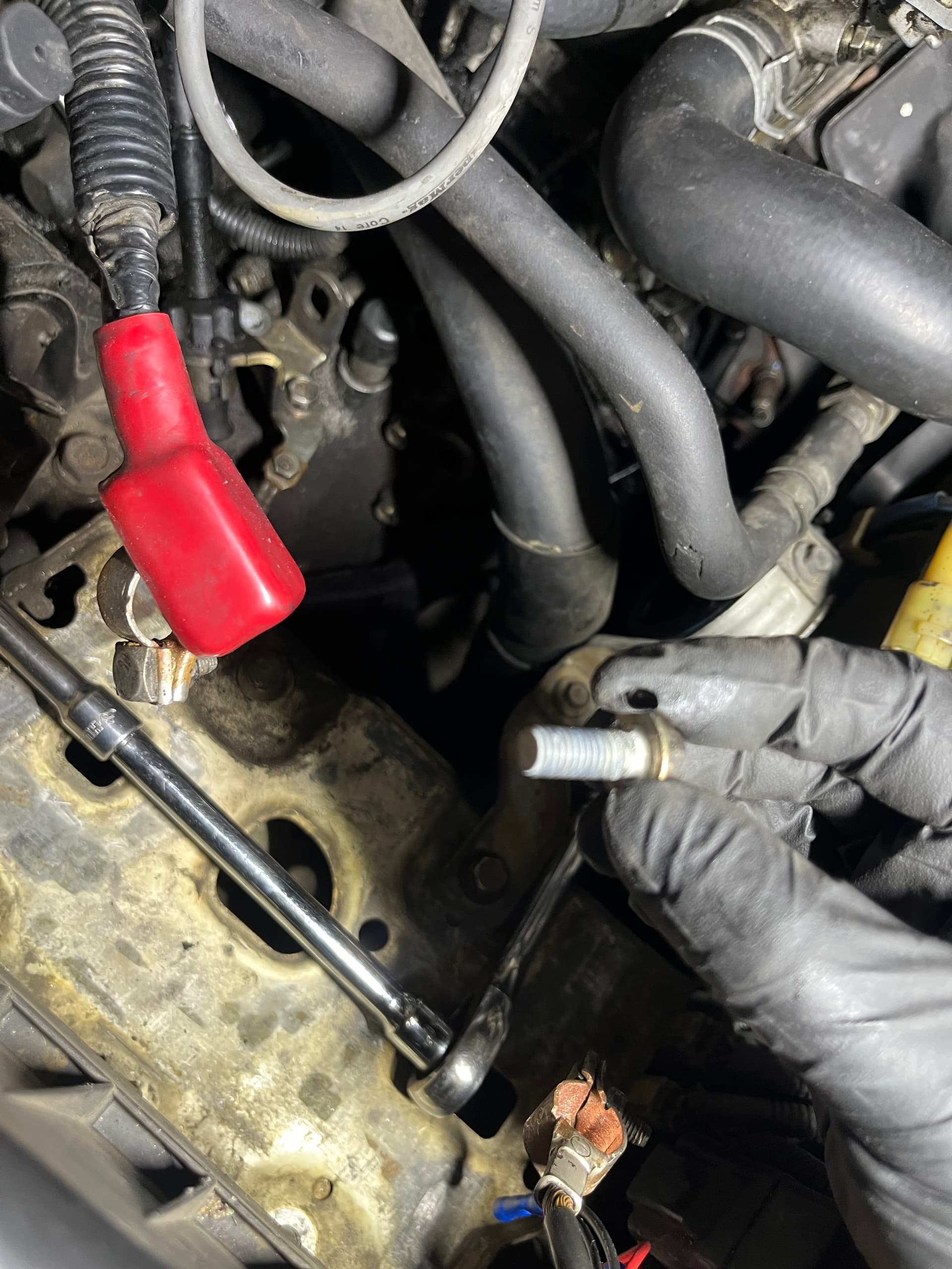

while i was cleaning the battery ground area i unscrewed the two bolts holding down the ground plate thing and i found a bunch of what looks like corrosion. the bolt in the back is worse, i thought it had a bunch of wet anti seize on it but these bolts havent been touched in years and the silver stuff is hard and wont come off the bolt easy i had to scrape the threads with a terminal cleaner.. i might use a tap and die set to clean the threads.
this is corrosion right? should probably replace the silver bolt
Can you clean it with some brake parts cleaner?
i need to buy some brake clean and spray it all down. i tried scraping the bolts to make them shiny and that silver stuff wont really scrape off. and i am even more confused about the bolt hole because it is very silver in there it looks like its full of anti seize. i was gonna run a tap through it to clean the threads.

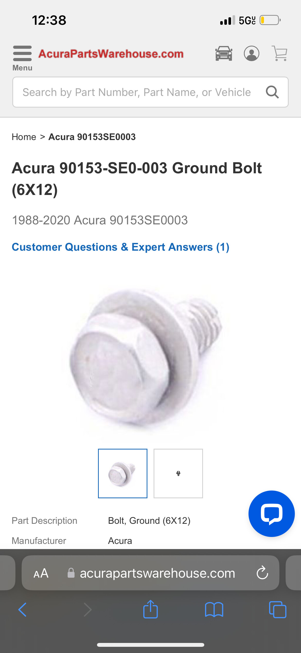

also when i look up the ground bolts it is already silver kinda so maybe its normal idk.
i feel like its not good for electricity to flow through especially the bolt hole
It looks like it may be galvanized.
