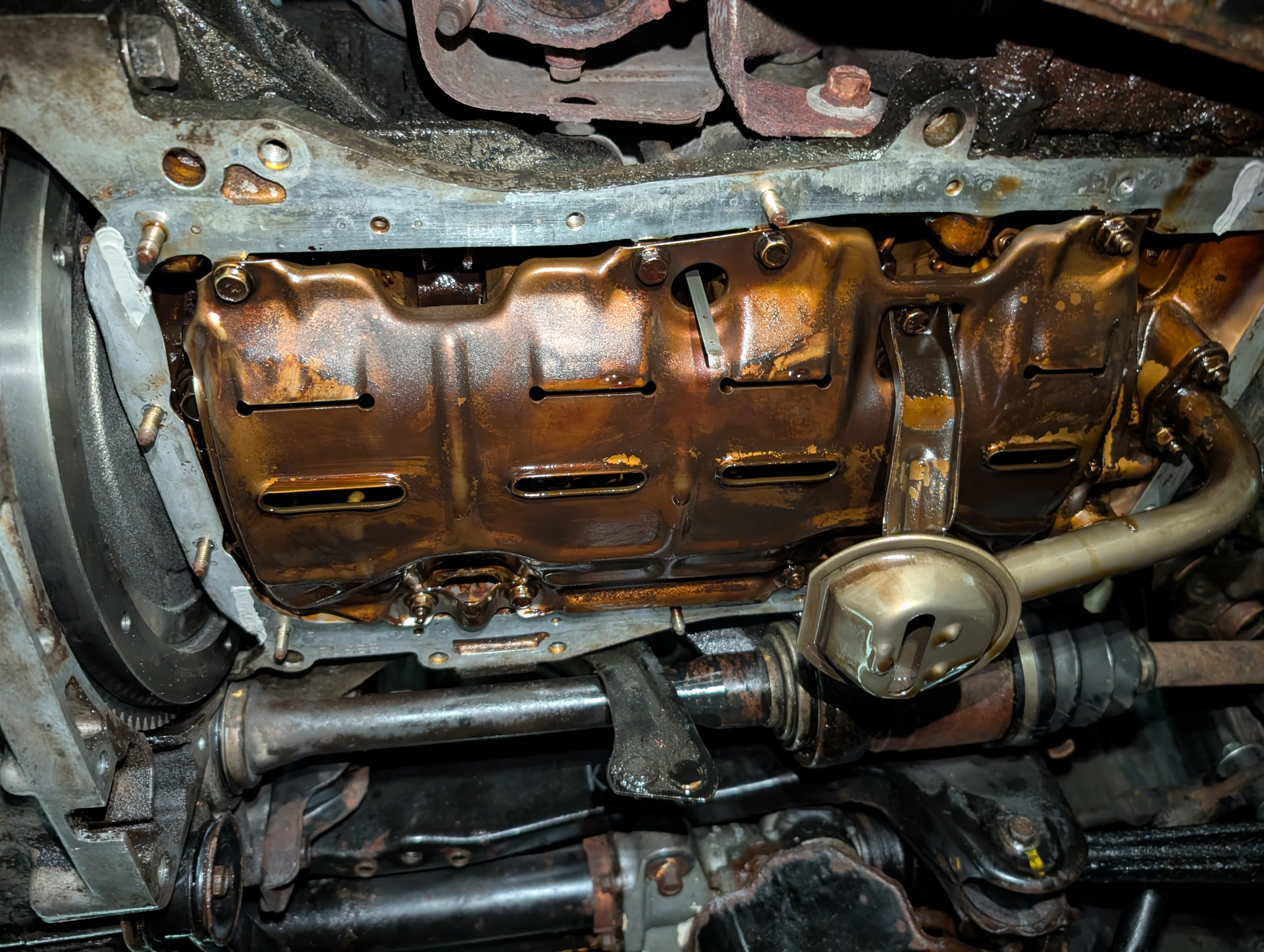

Yesterday was oil leak day. I got the oil pan bolted back up but not pictured. Oil would not stop coming down near the timing cover so hopefully it didn’t interfere with the silicone bead over on the top right lol.
I also learned I’m leaking from the oil pressure switch so once I get another second of spare time I have to buy a socket from farm and fleet and pop that out.
Hm, I don’t remember my underside there being so dark. Do you have a sludge issue? what oil do you use?
I’m gonna ask the Mrs to get me an automotive steam cleaner for my birthday. I hate all the sandy gunk and I have a lot just like in your pic.
I have a “this car was probably run at 2000rpm for 100k miles by an old couple” issue lol. Valvoline restore and protect 5-30 is going in there to begin removing the varnish.
The pan itself only had a very light film on the bottom, no real buildup.
