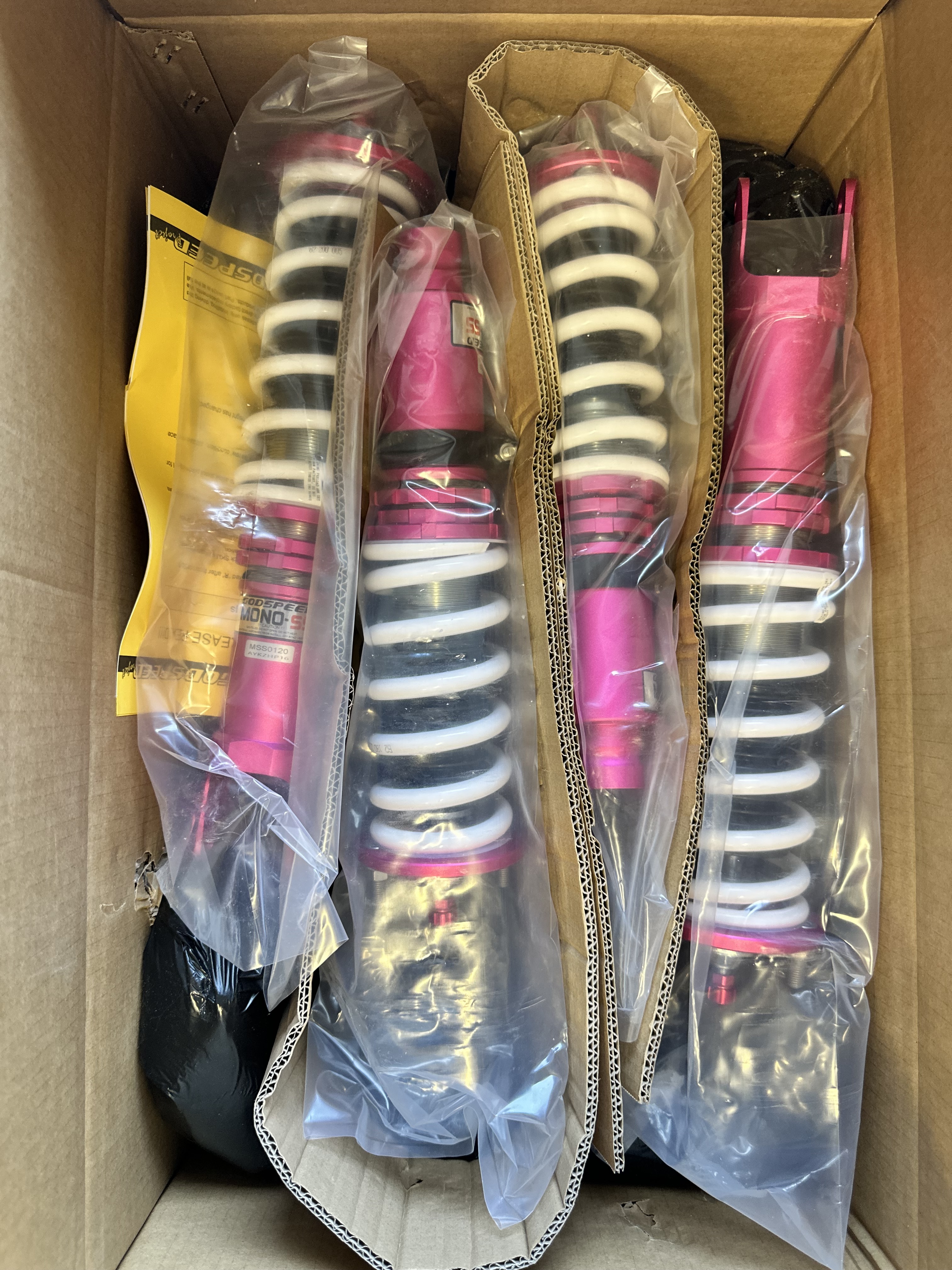

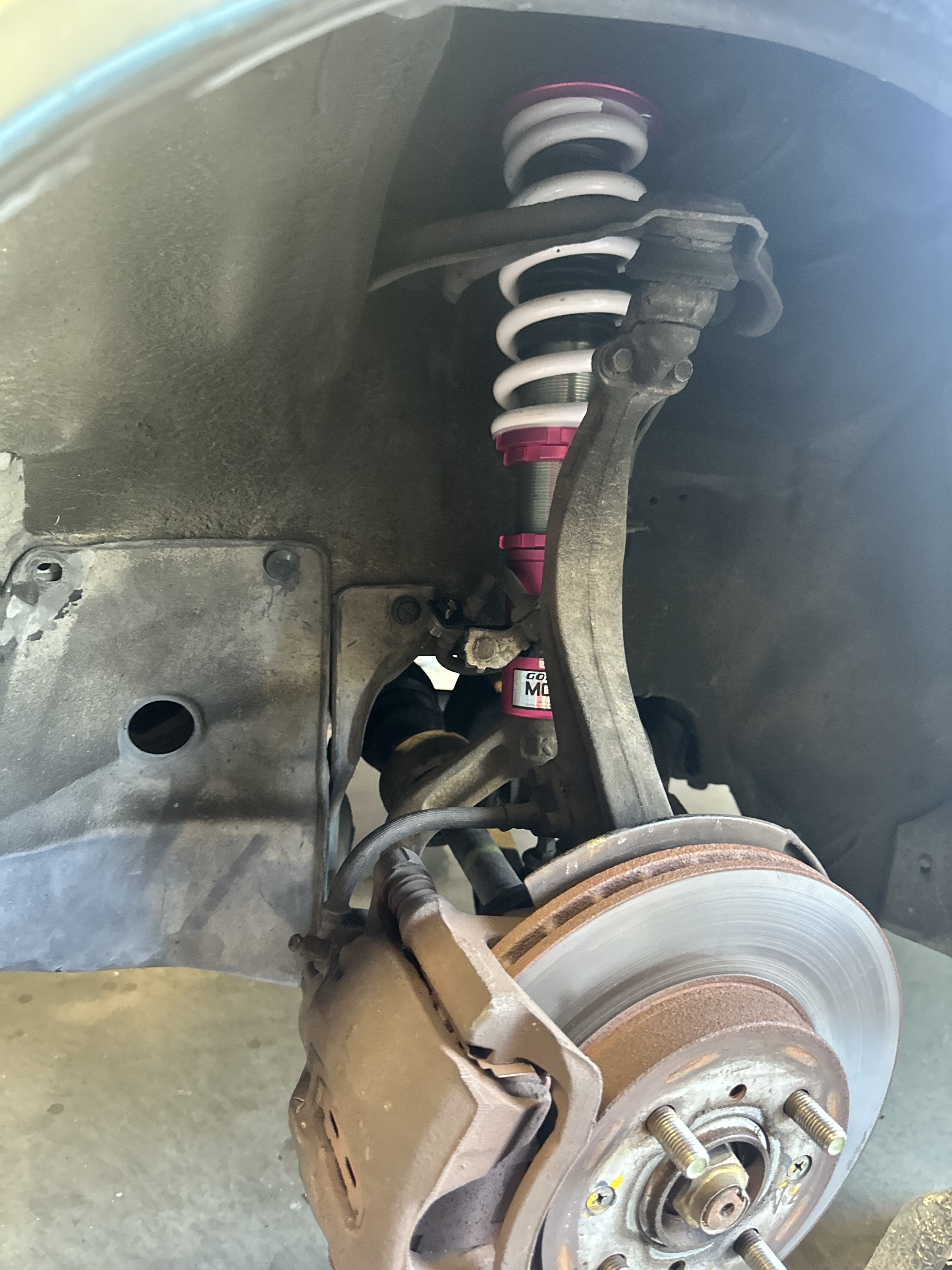

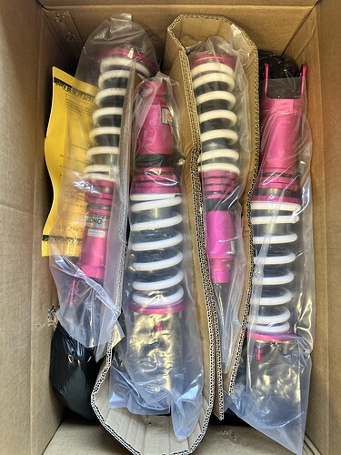

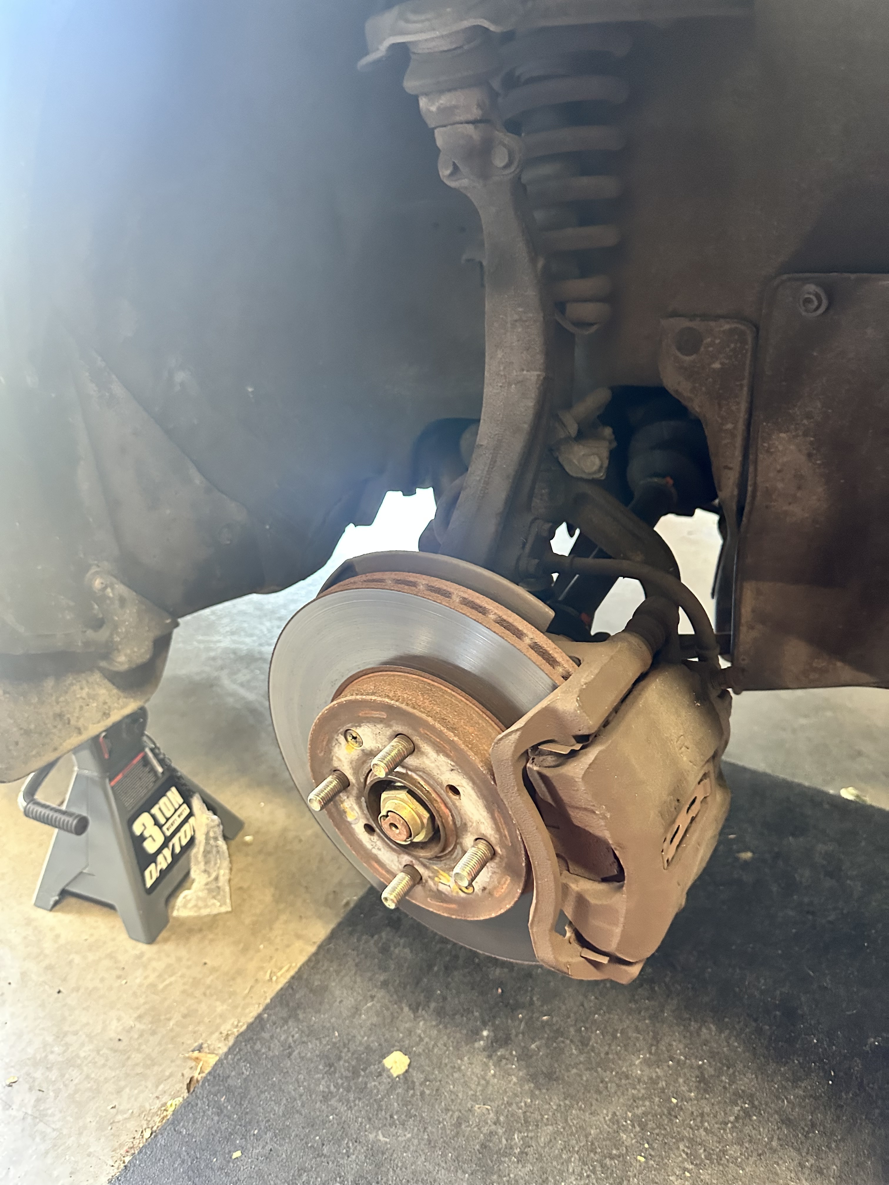

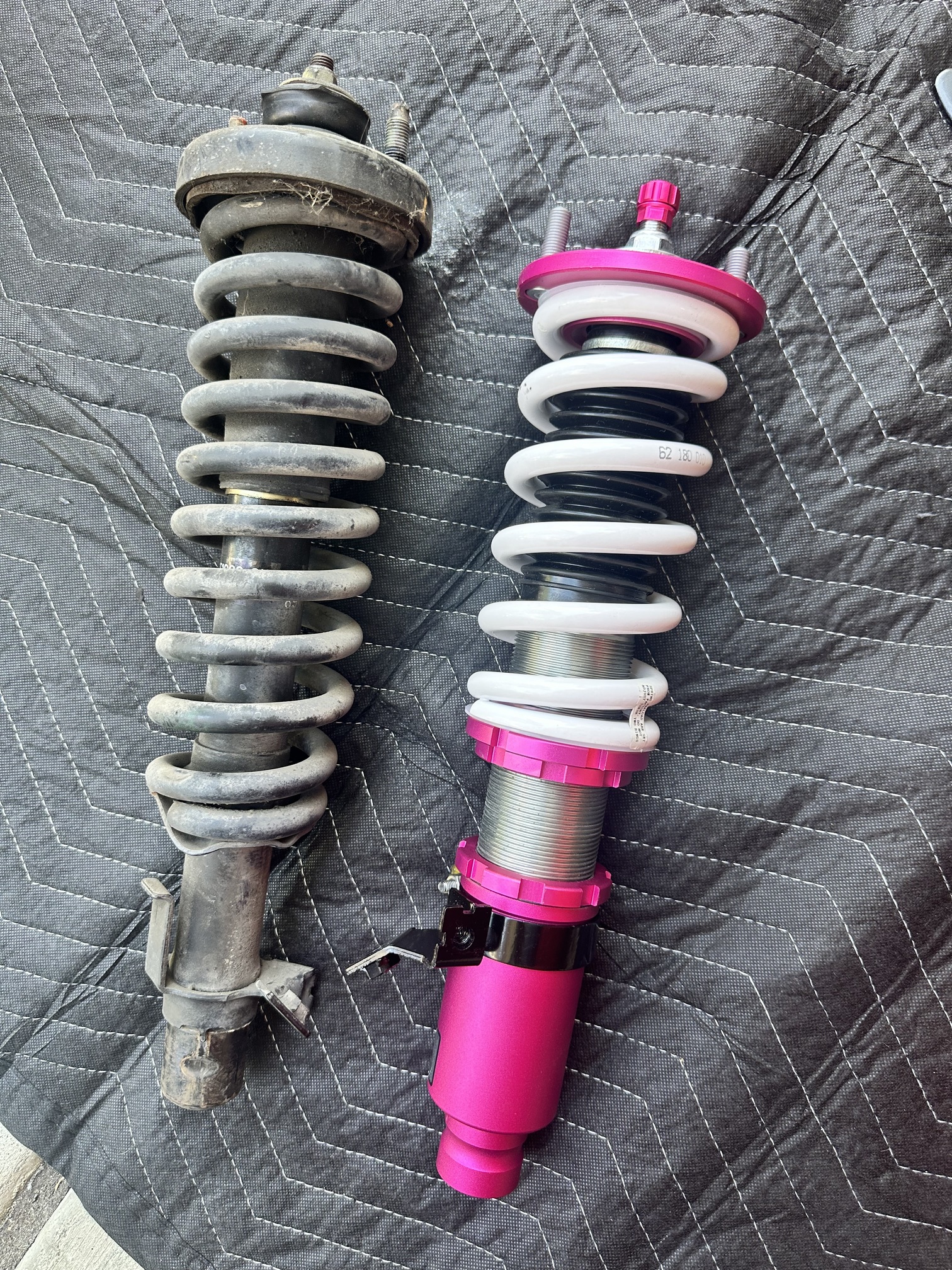

Been MIA for awhile. Kid’s build took a back seat while he worked most of summer. Anyhoot, he purchased some coilovers. Got those installed this week. Have to still dial in the ride height but we got them installed.

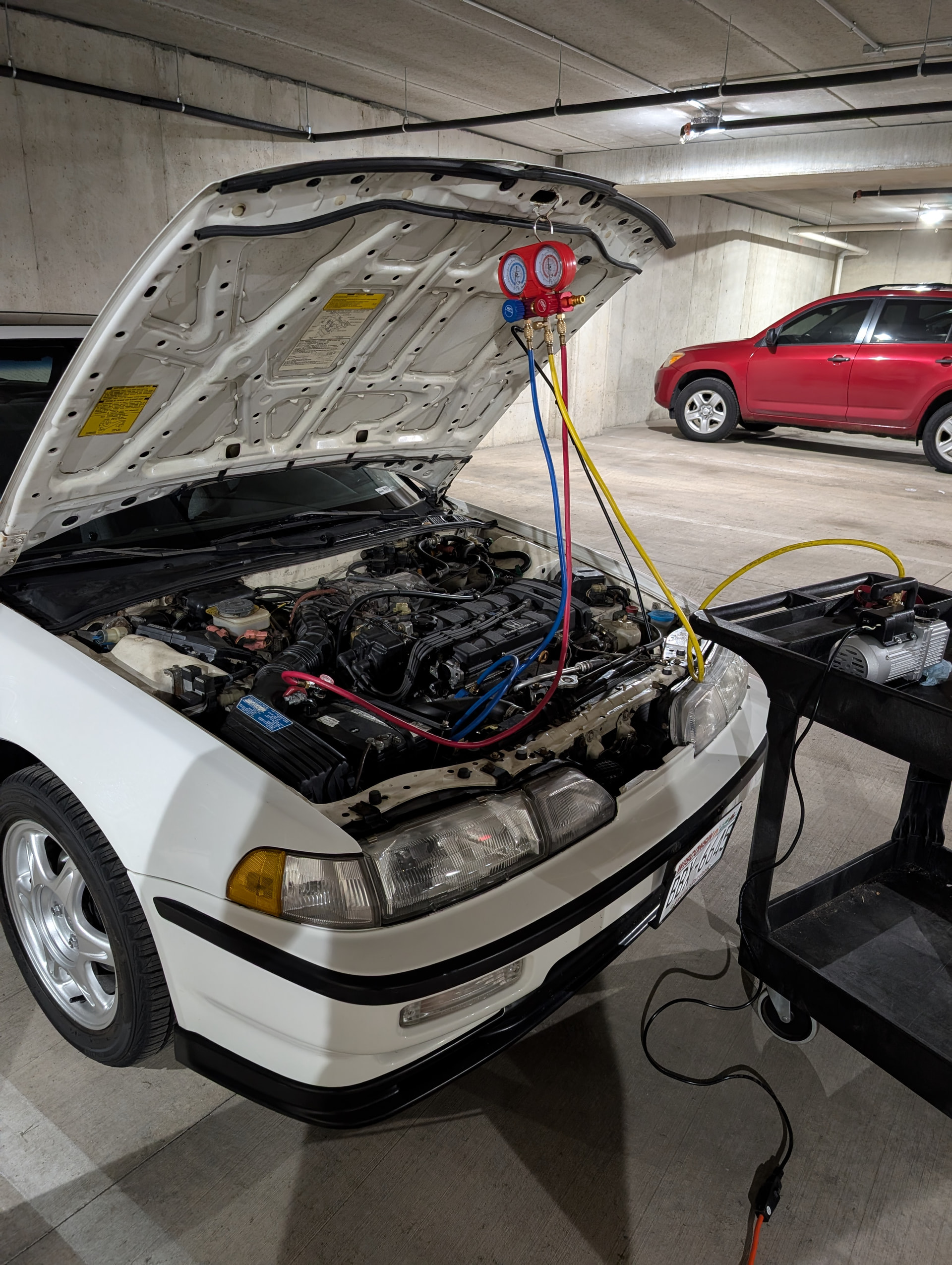

I have the gauge set at least. I bought it for the house HVAC because I wanted to determine pressures but never got around to it. I wonder whether I can use it to check the car.
If it looks like this you should be able to. What’s going on with your A/C, is it empty?
I basically followed the chrisfix video on how to vacuum and recharge the system.
it is partly due to the ac switch constantly failing. I’ve gone through 3 or 4 of them. I’ve actually been thinking about designing a new universal switch and housing because it has been so failure-prone.
That’s wacky. But as long as your actual gas loop is closed and pressurized that makes life easier
I’m assuming if I try to pull vacuum on the system and it can’t… that means there’s a hole. That in itself is probably super helpful.
Yeah, you should be able to get your system to around -27mm hg which is about as far as the cheapie autozone rental pump can go. If you can’t get it that low that means you have a small leak somewhere, and if it doesn’t get past 0 then you have a big leak.
Then you shut the valves and see if the vacuum needle drops towards zero. If it more-or-less doesn’t move for a half hour, your system should be considered sealed enough for your refrigerant to stay in there at least a year or two.
Also, don’t try to pull a vacuum if there’s pressure in there. lol.
