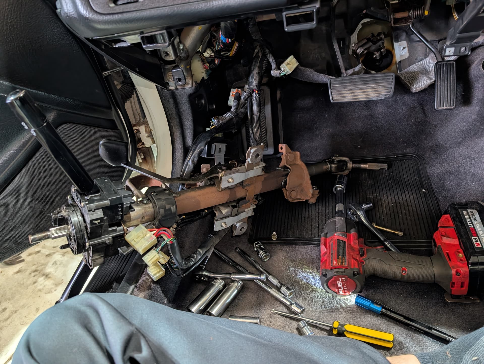

We’re back running and driving, ladies and gentlemen.

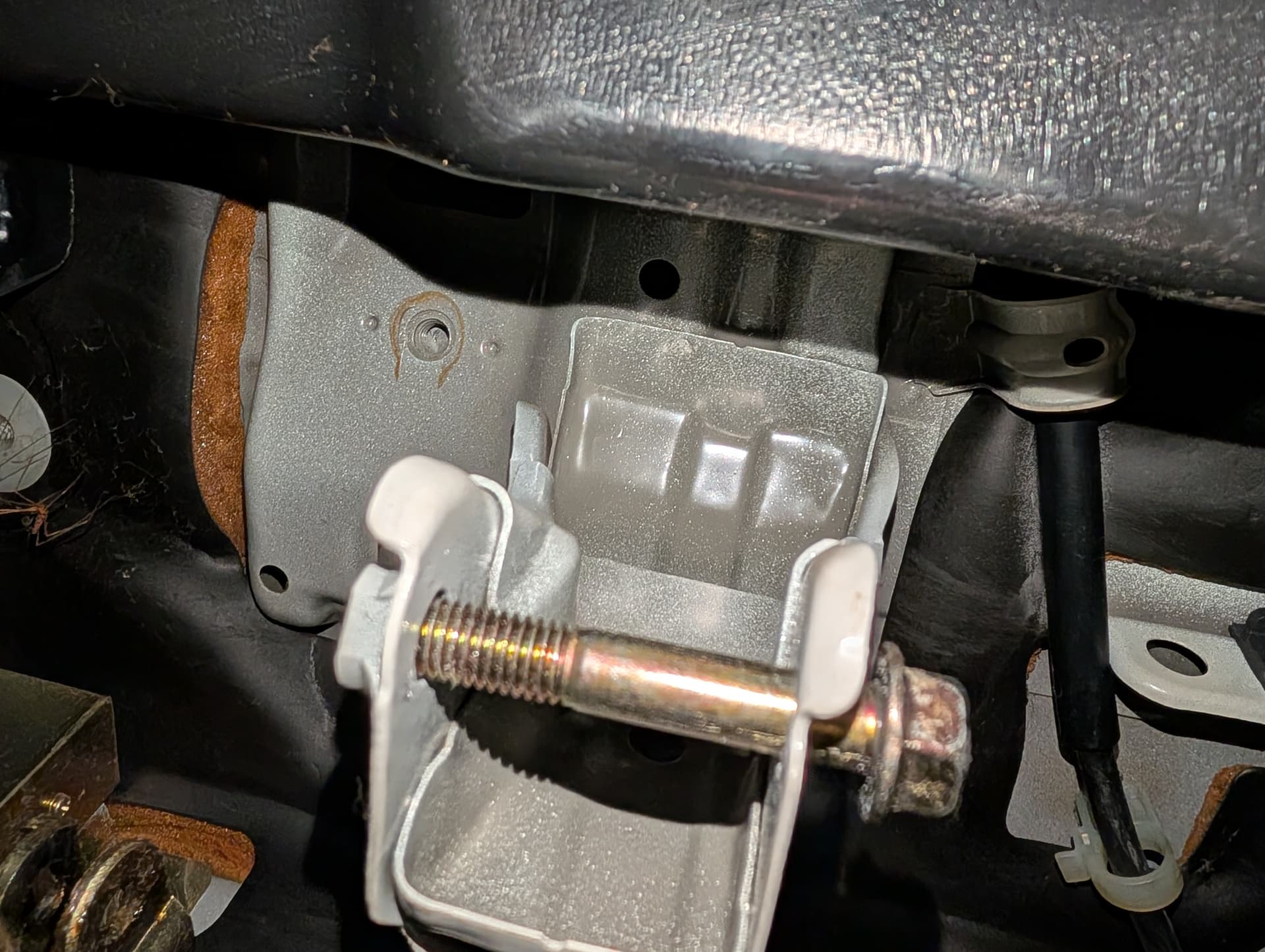

The pedals were pretty awful. I basically couldn’t remove them without pulling the column and setting it to the side. Luckily I was able to keep the turn signal and ignition switch on it:
There was also no way to get to this bolt (it was in the hole with witness marks) without ripping out the driver’s defroster duct (this photo is looking up into the underside of the dash, there used to be a second vent tube here):

Thanks! It was a ton of work, and I’d only really recommend the swap to someone if they can give it a few hours a day after work or over a couple weekends. But none of it is particularly complex. You just follow the manual, except for the pedals which I couldn’t find in the HELMS (steering column removal was in there though).

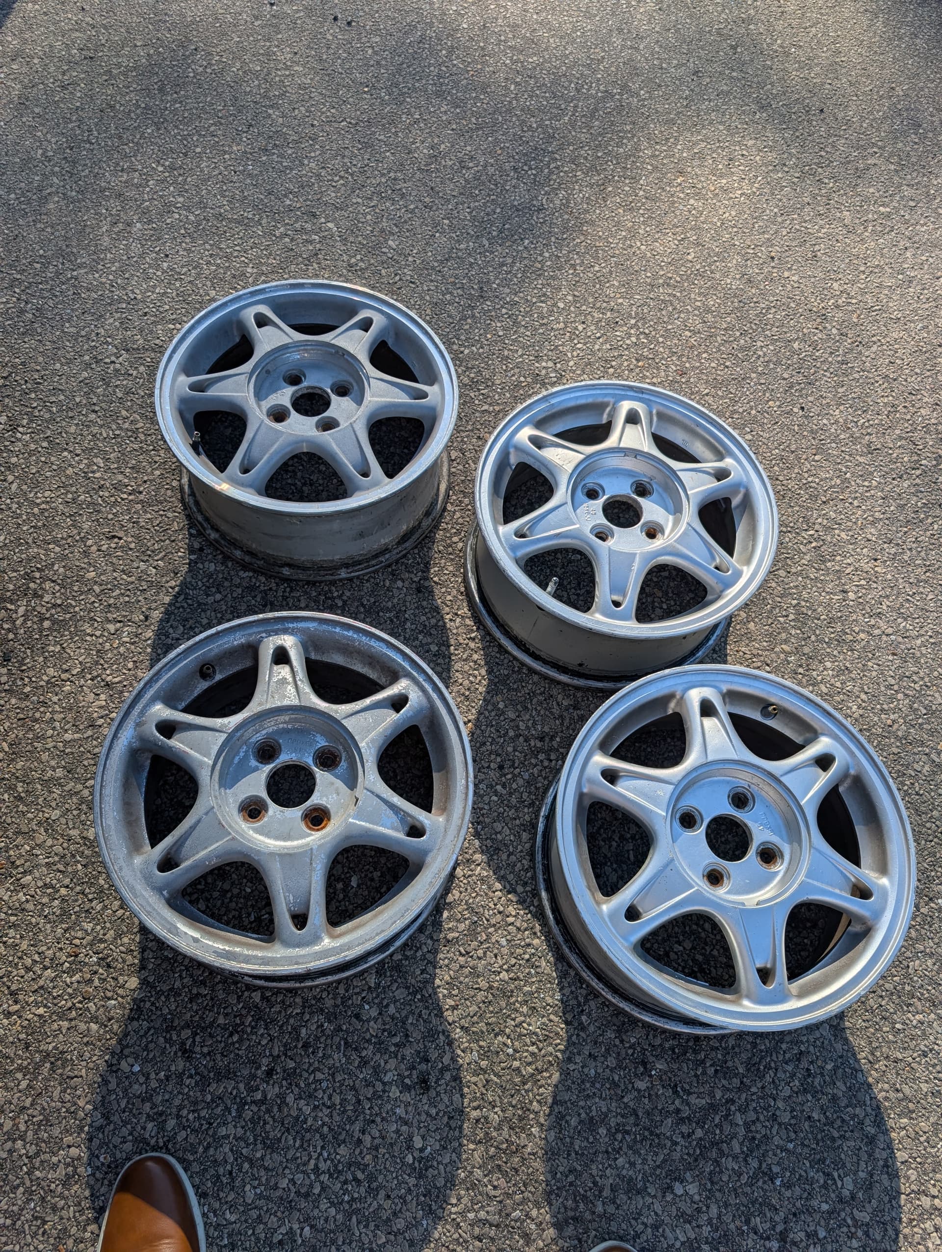

I may or may not be refinishing some 96 SE wheels to replace the 14’s on my car.

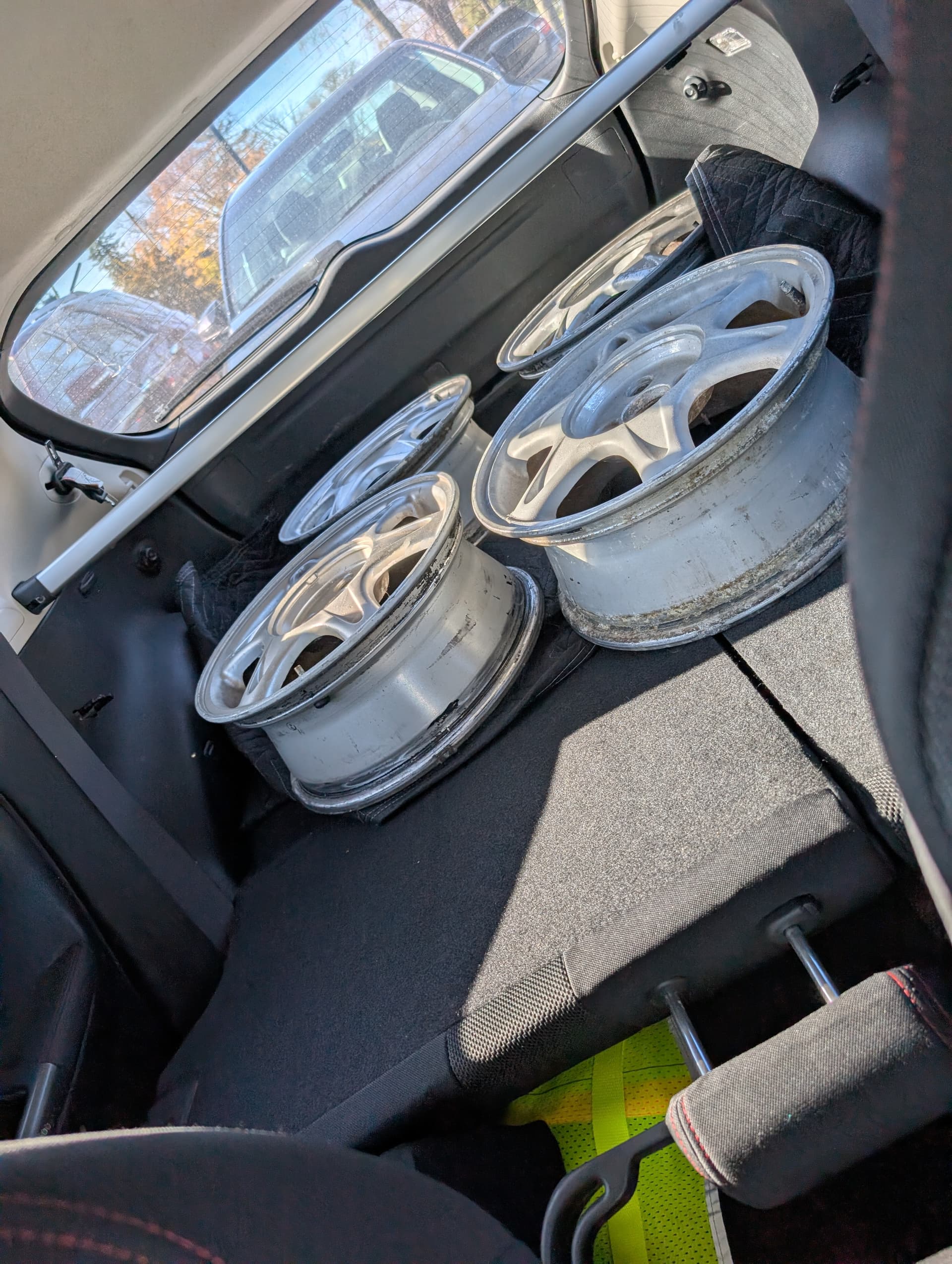

Why do I do this to myself. (It’s because I can’t sit still)
LOL good deal? No centercaps? :frowning:
$100 bucks so fair. I like them better without the center caps!
holy crap I would buy that too just for a backup.
Yeah. I’m gonna be putting in the elbow grease on these to make them half decent though!
Side note, this is the third time i’ve bought parts from these guys. Hah.

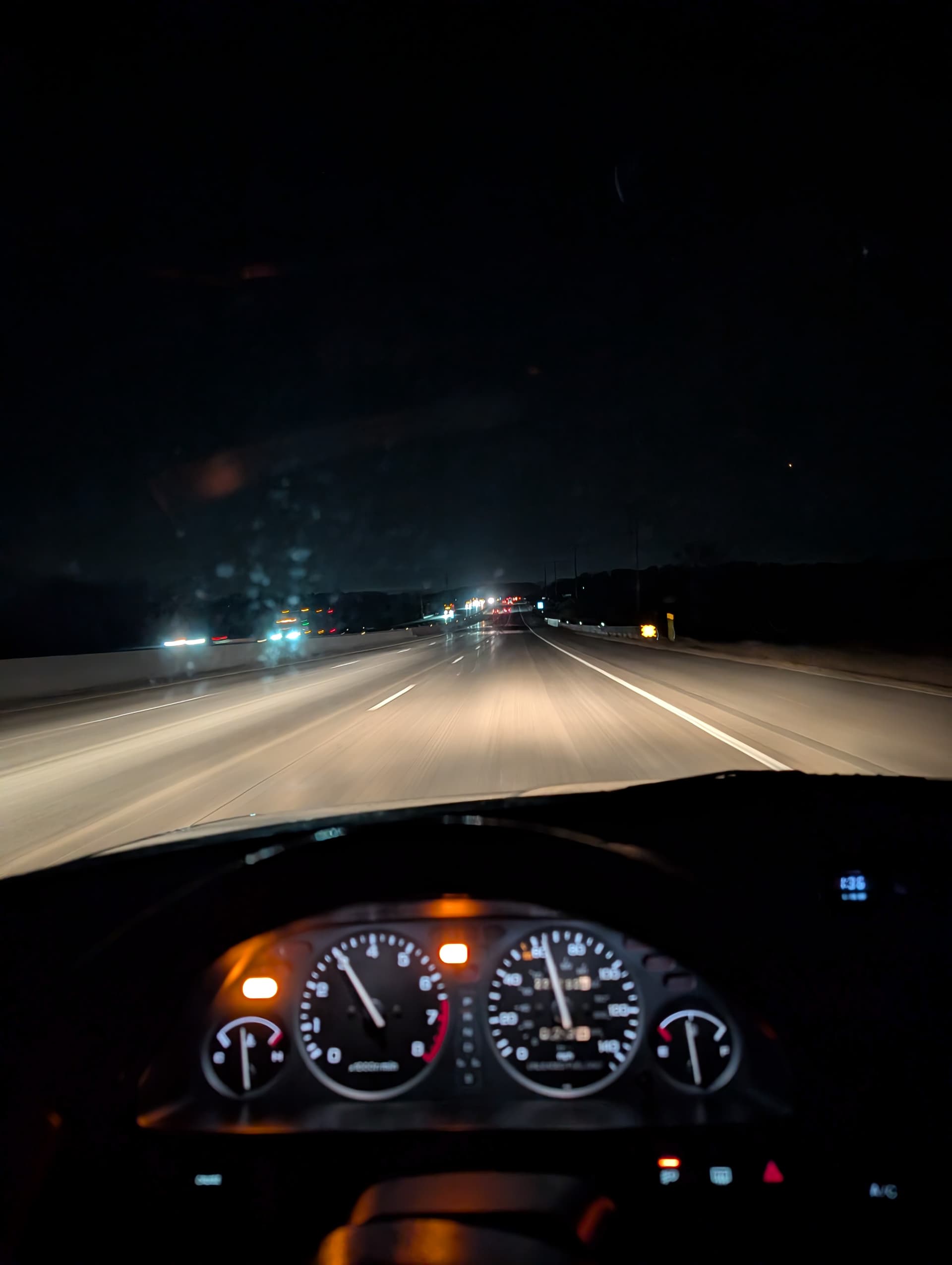

Drove the whip home last night! 45 minutes without issue.
I get a little vibration up through the steering wheel around 65-72mph. Not sure if it’s the axles or if the 14’s and Tiger Paws just suck though.

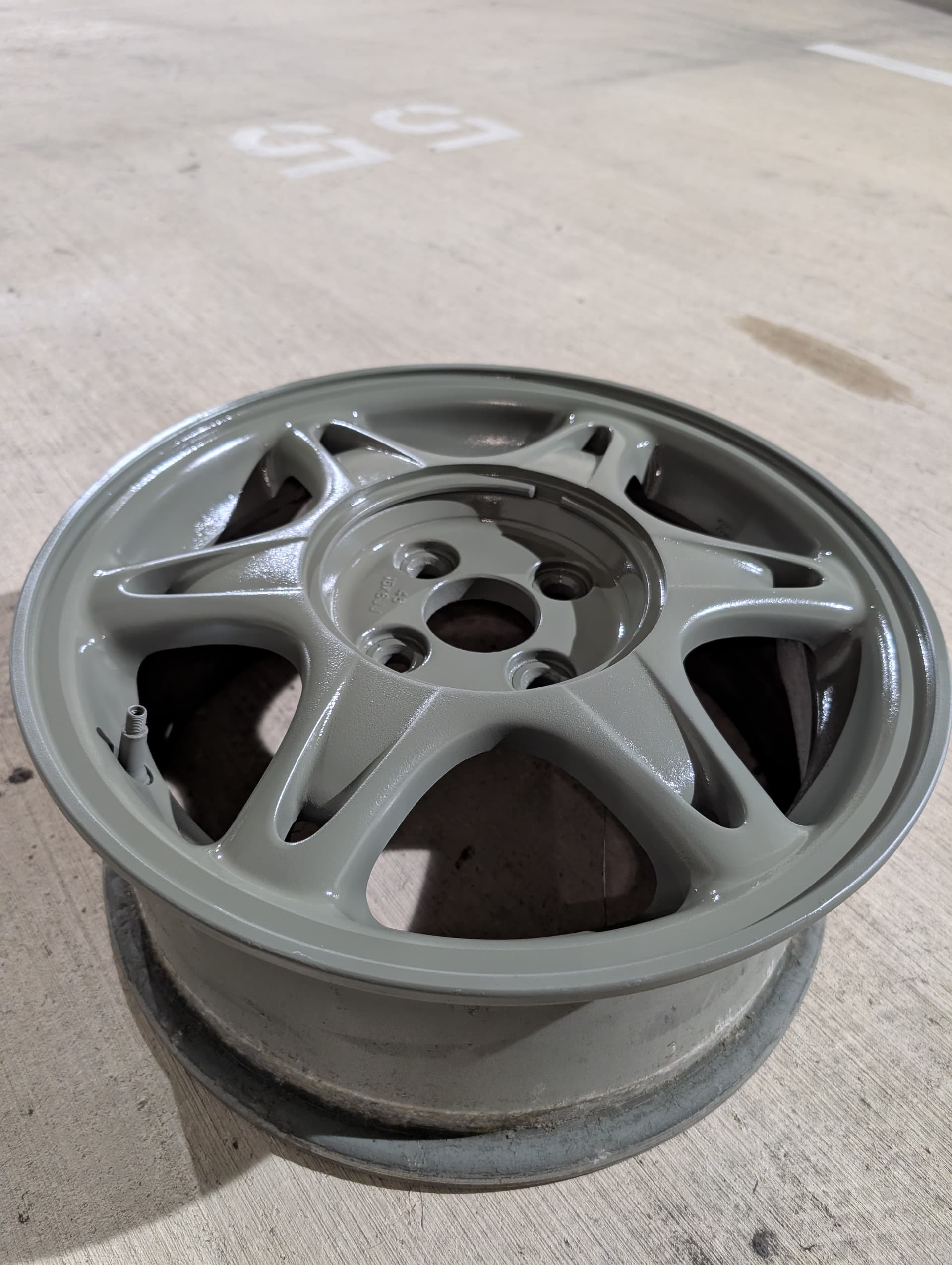

Two wheels sanded and primed:
looks good in the rain :slight_smile:
