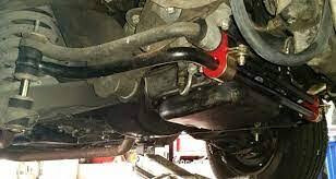

So I took it for a rip yesterday on some roads, it definitely feels a little less rolly in the rear but that could be due to the “better” primary bar with less-shot endlinks.
Looking back at where my attachment points are, I think I might move the middle two points to the front/back section of bar just after the brackets. The effective lever arm from having the inner bushings where they are now probably does not add a lot, it’s like half the lever arm of the primary bar.
Volvo guys apparently double up swaybars on their cars which is where I got the idea:
I had no idea doubling sway bars was a thing.
It’s kind of dumb in most cases, because increasing the diameter of the bar (read: buying a bigger sway bar) quadruples the spring rate versus the increase in diameter, where I can only double my rate at most by having double the bars. But nobody’s selling me their ST sway bar so I got bored :sweat_smile:
I also think that the majority of any potential stiffening is dependent on the bushing screws/metal band. I mean that would have to be as rigid as possible. Right?
Ideally
