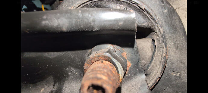

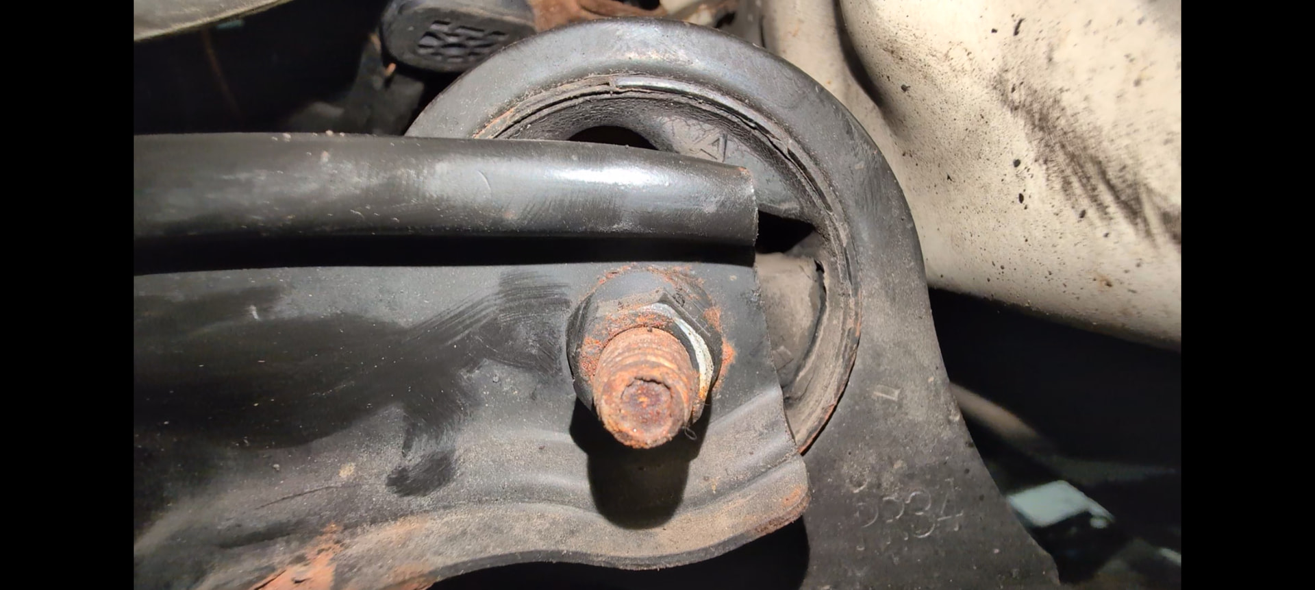

Definitely ripped. Zero clue how to access the back two bolts holding the mount on but I’ll figure something out. Doesn’t seem like you can get at them from the engine bay.
From what the mechanic said, he was only able to get to it while it was on a lift (and thus, from underneath).
I agree with your guy. There’s space behind the subframe under the car to access the bolts but you need a low profile breaker bar or a looong 14mm box wrench. The problem is you need something that gets on the bolt and allows the handle to slope down towards the floor. My 14mm was the only tool I could get on the bolts but it’s too stubby to get leverage to break them loose.

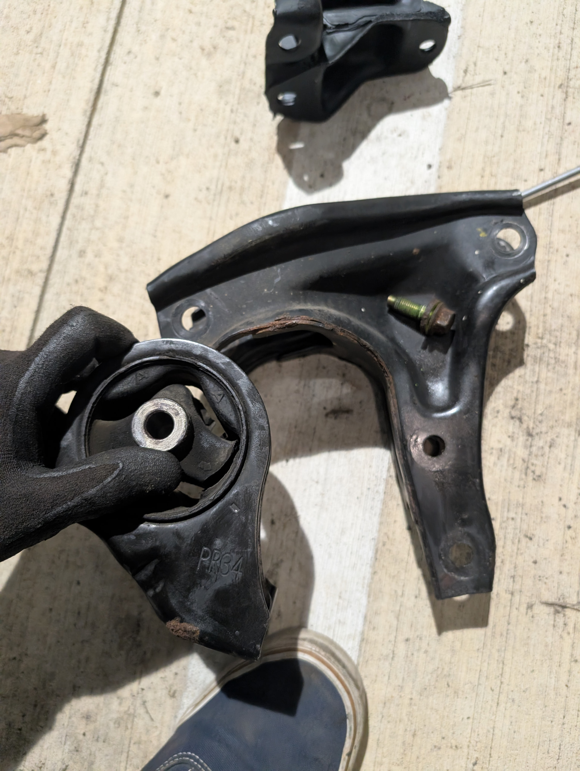

New one looks just like the old one but with less splitting and dry rot.
holy crap did it work from underneath?!
Yup I just had to muscle the two back bolts out, barely enough room with a 3/8 ratchet and 14mm socket. You can, in fact, get one of the back bolts and the front bolt from the engine bay with extensions. Got the motor mount thru-bolt out from the driver’s side wheel well and 24” of extensions.
