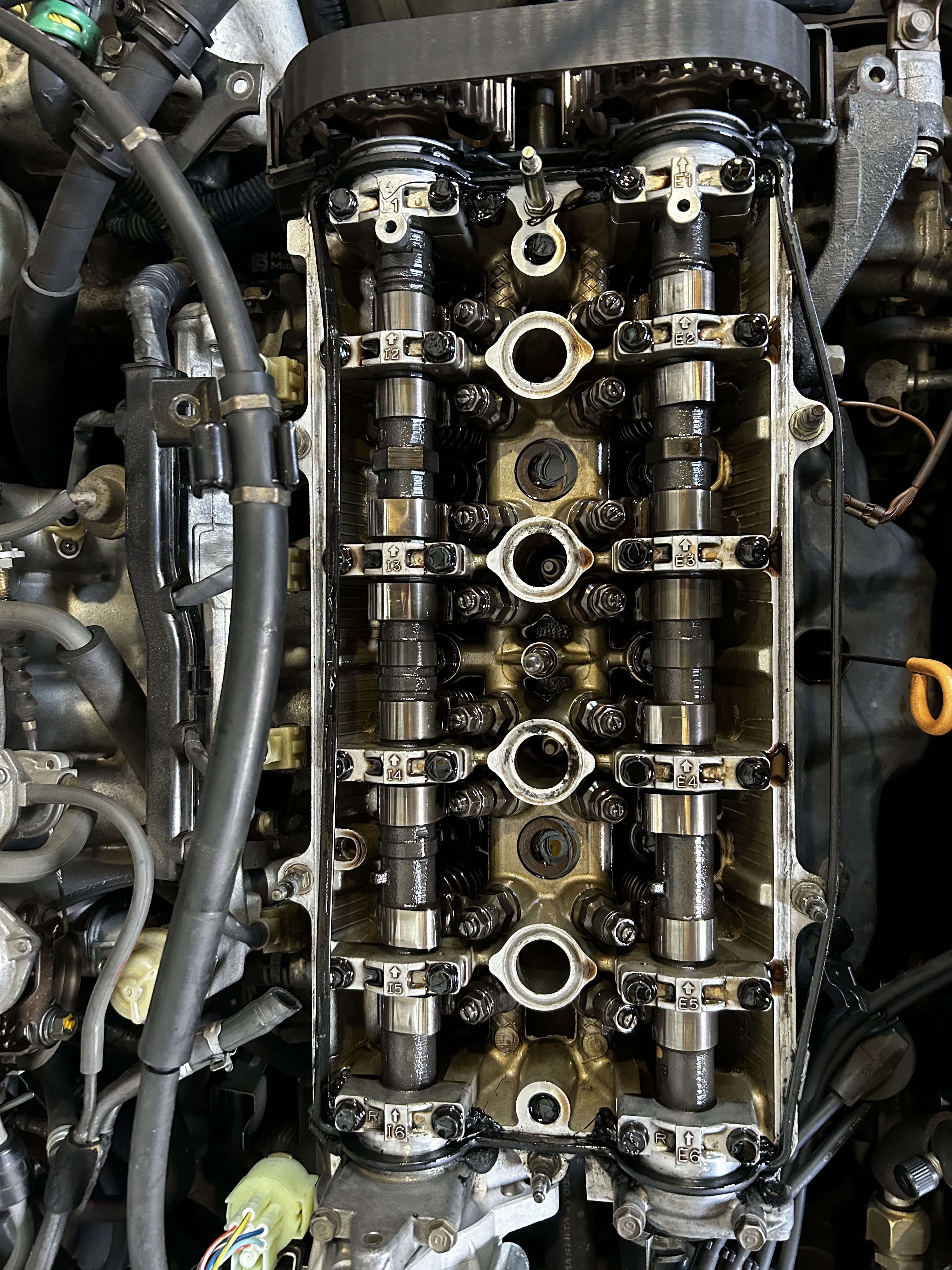

Was doing the valve lash adjustment last weekend. Noticed my timing belt is pretty stretched out and my exhaust cam was off 2 teeth. (No drivability issues surprisingly, I only checked it as I was doing the valve lash and had the valve cover off)
With the amount of time its been since the last replacement(Like 30,000 miles, but i think 8 years old) it’s definitely due it. Gonna do the water pump and cam seals with it too, to hopefully get rid of the last of the engine leaks.
