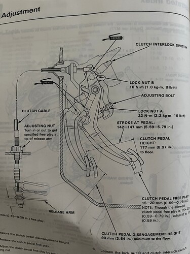

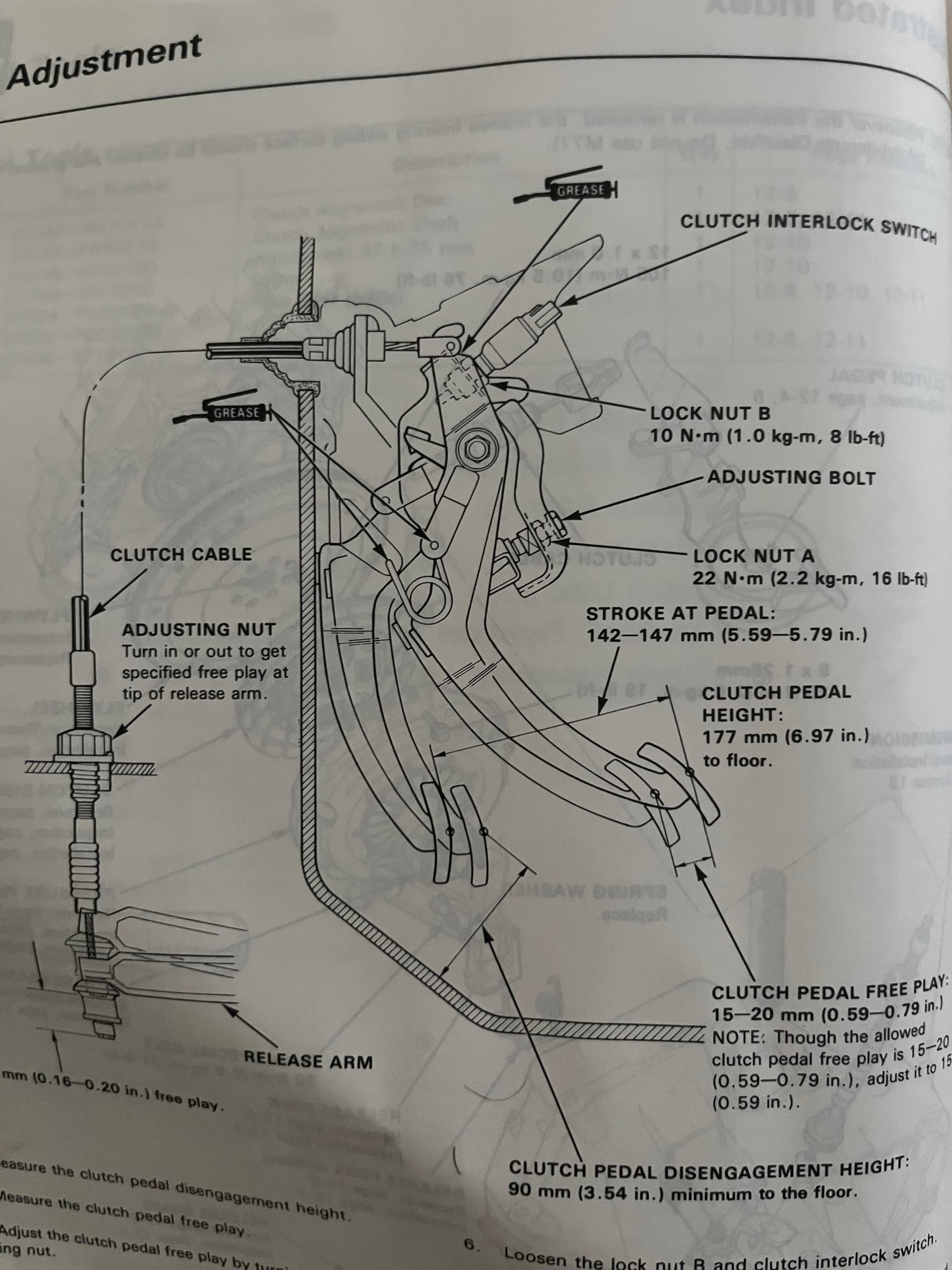

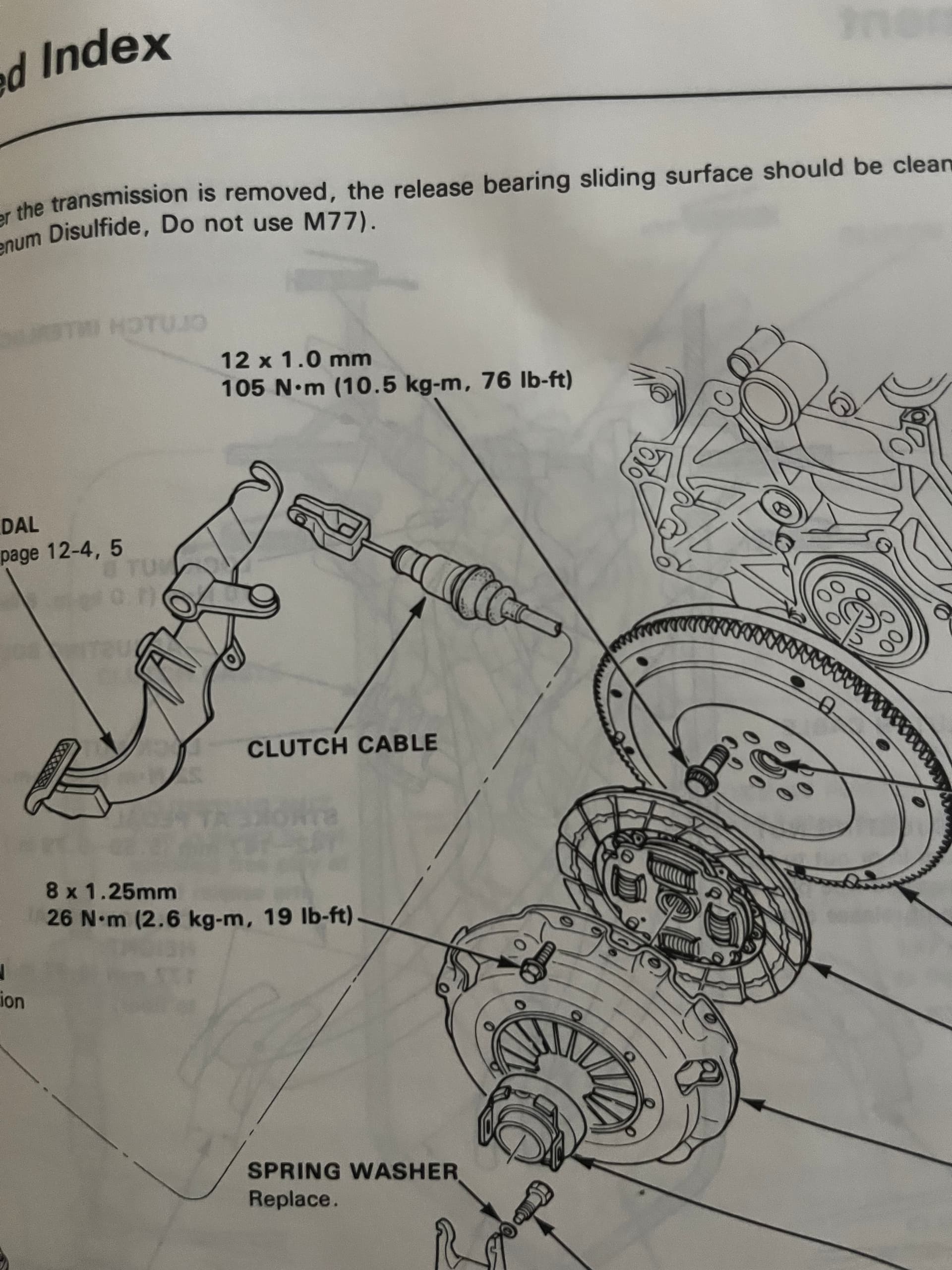

Thanks for posting the pic. I forgot again.
Thanks dude! I actually cut/pasted a lot of the HELMS into a pamphlet for me and my buddies to use as instructions lol
