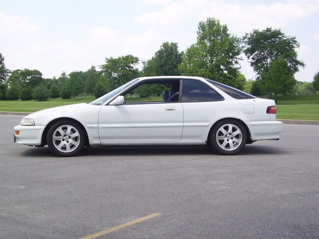

here’s what s. tech techs will look like.
good 4 daily driving u guys think ?

man everyones drop on teins looks diff to me =/

well that’s what they are supposed to be but the front spring rates are lower that stock rates so you get more of a drop mine basically looked like nar93da’s pic
