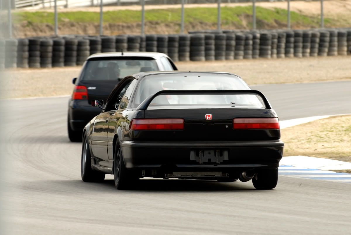

[QUOTE=sharky0708;1718229]Has no one stagerred tires for handeling improvement not drag improvement.
Does it not help? Does it make it worse?[/QUOTE]
225/50-15 front, 195/50-15 rear.
