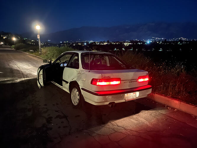

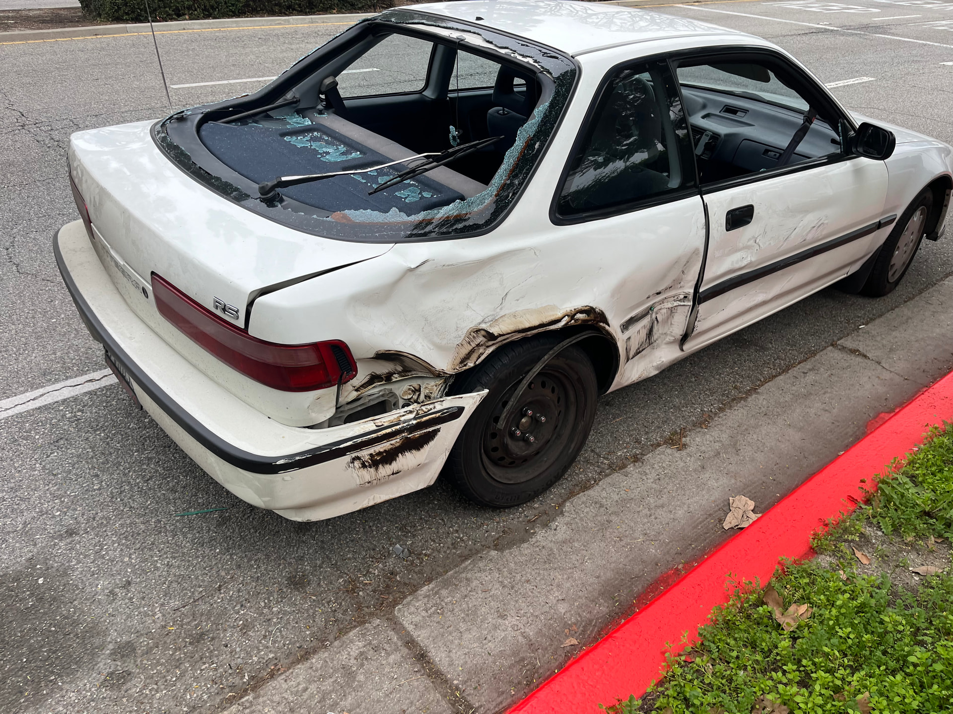

not sure what to do with my integra as i was in an accident with a hit and run driver and then a second accident with a semi truck in the same day. the semi truck accepted liability so i am just waiting for insurance even though its been a month already.
i dont really want to sell the car to a junkyard, i might let the insurance take it but the engine and transmission and radiator and everything are still good its just squished on both sides. and both rear tires suspension is slightly bent because the rear tires have negative camber and is eating away at the inside edge of the tires. but i still drive it for fun sometimes its just the tires will eventually get down to the wires but the interior is nice maybe someone on here could use it for parts?
:frowning:
Keep it for parts, find somebody’s abandoned project and make a new one?
I see a decent amount of DA’s on marketplace that look like abandoned projects, you have a template of how and where stuff should go with this car, wouldn’t be too hard to bring a basketcase back to stock.
ive already salvaged it twice too much of a money pit lol
Idk, I would low-ball some of the people I see selling in southern cali and try to get a good shell to swap all the stuff into. Or part out and use those funds towards something. Interior stuff seems to go for good money on eBay.

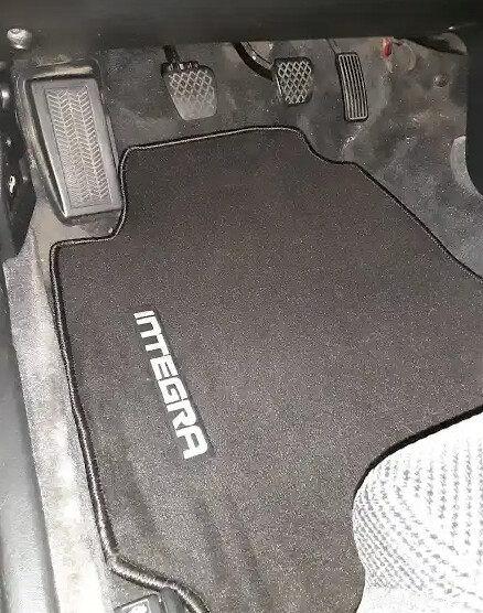

What are those floor mats? I got some “INTEGRA” remakes and they’re okay. I’m on the fence about them. I’ve been thinking about getting some aftermarket floormat holders.
The brand is P2M. They’re decent, fit is about a 9/10 with 10 being OEM fit. They didn’t lay in perfect for me but I think they’re working in with the footwell vents blowing heat on them. For 99 bucks for all 4 mats I have no intention of complaining lol
Yeah the remakes are 90% too.
The P2m’s hug the dead pedal and the hatch lever better than that. The only issues I had was the relief cuts in the back two mats weren’t cut far enough so they kind of overlap the seat rail mounts a bit, which only becomes a big deal if you’re moving your seats on their rails a lot as the mats will get bumped.
I still have my OEM mats and I feel like I could make a better set by just using them as a template and cutting some carpet with a rubber gasket around the edges.
Dude you could make some sweet bowling alley carpet floor mats. Pair this with some blacklight footwell lights and you’re set.
Here’s the driver’s mat fitment.
