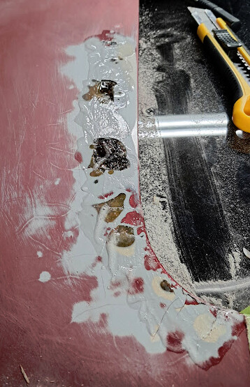

Uuugggghhhhh

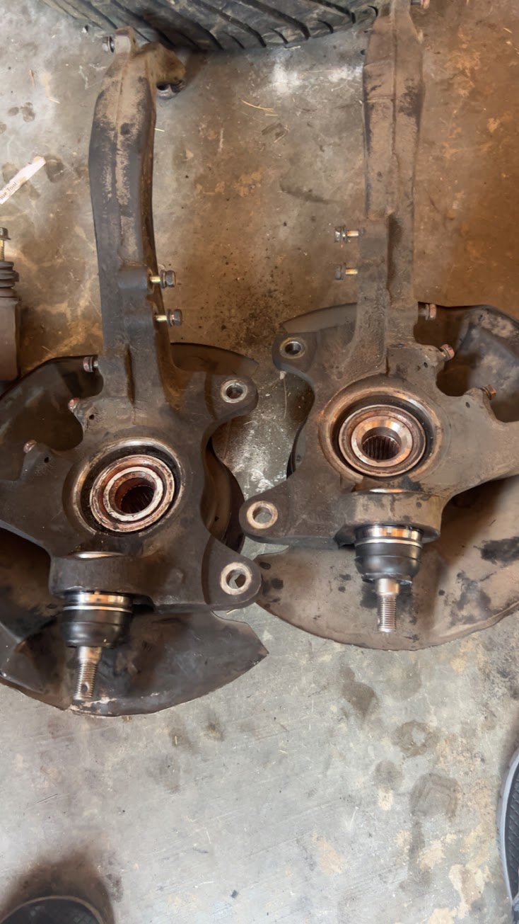

Sitting in some rust treatment. Luckily it appears to only be surface.

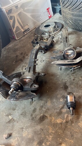

Got my new lower ball joints installed yesterday, and got the knuckles installed last night! I then, took it on a quick 5 mile test drive.
No weird noises and she handled great.

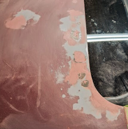

This is pretty smooth now. Need to prime it next.

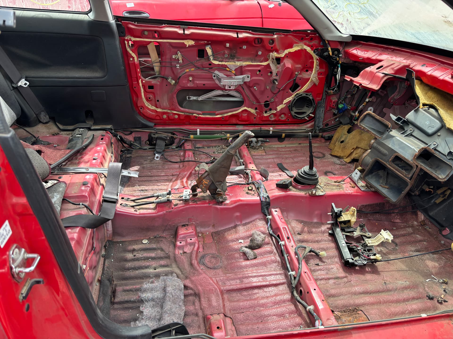

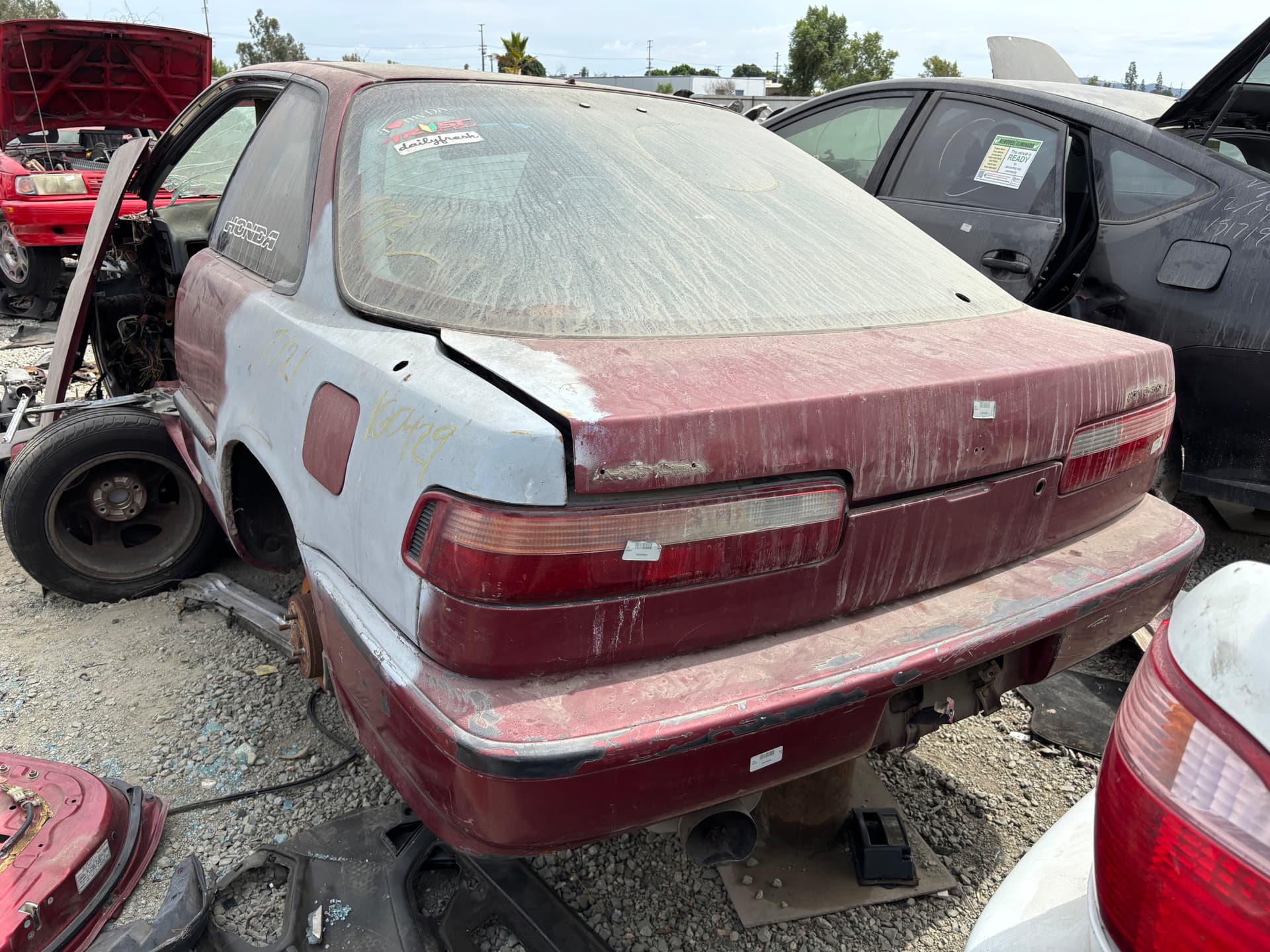

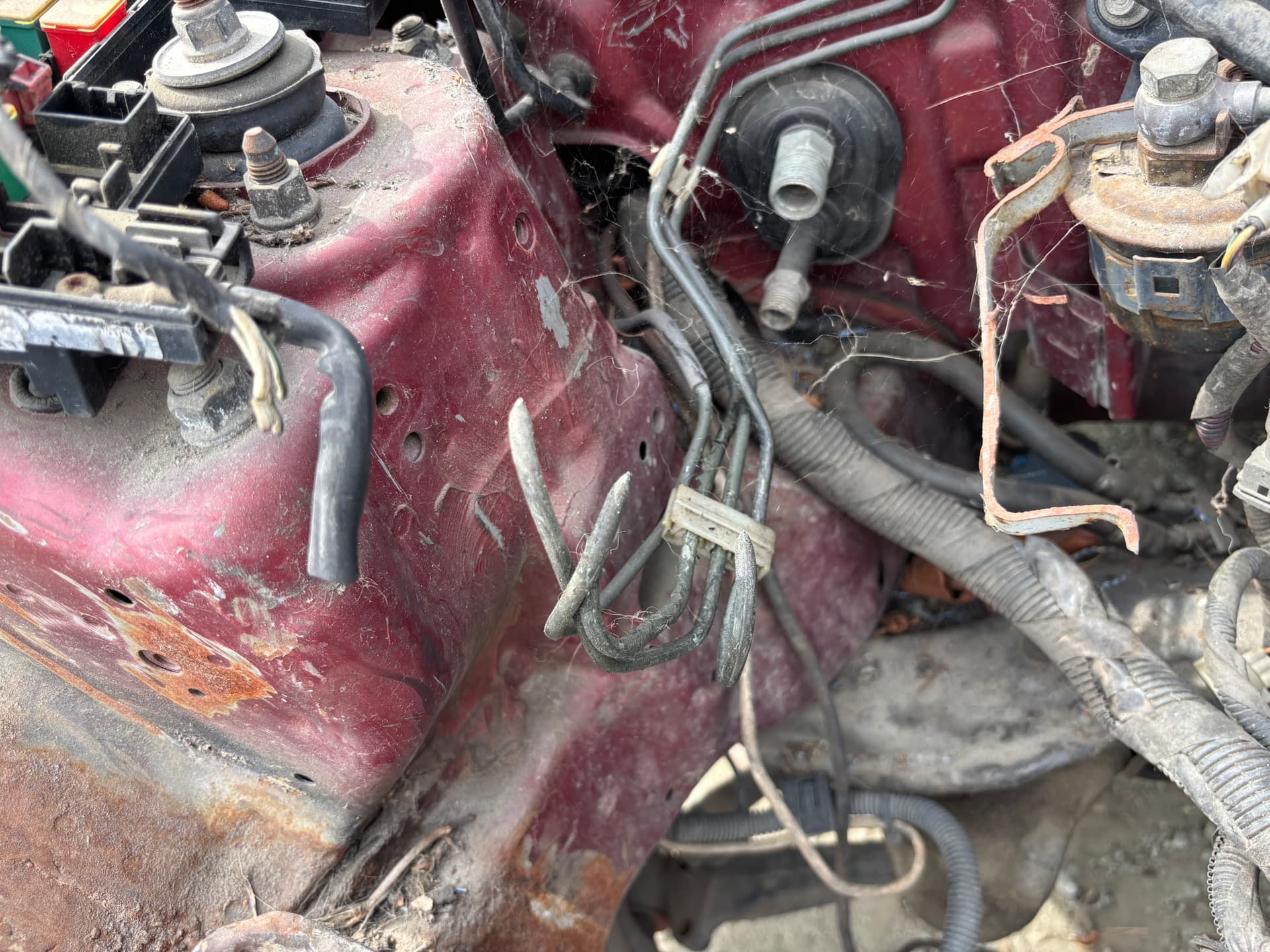

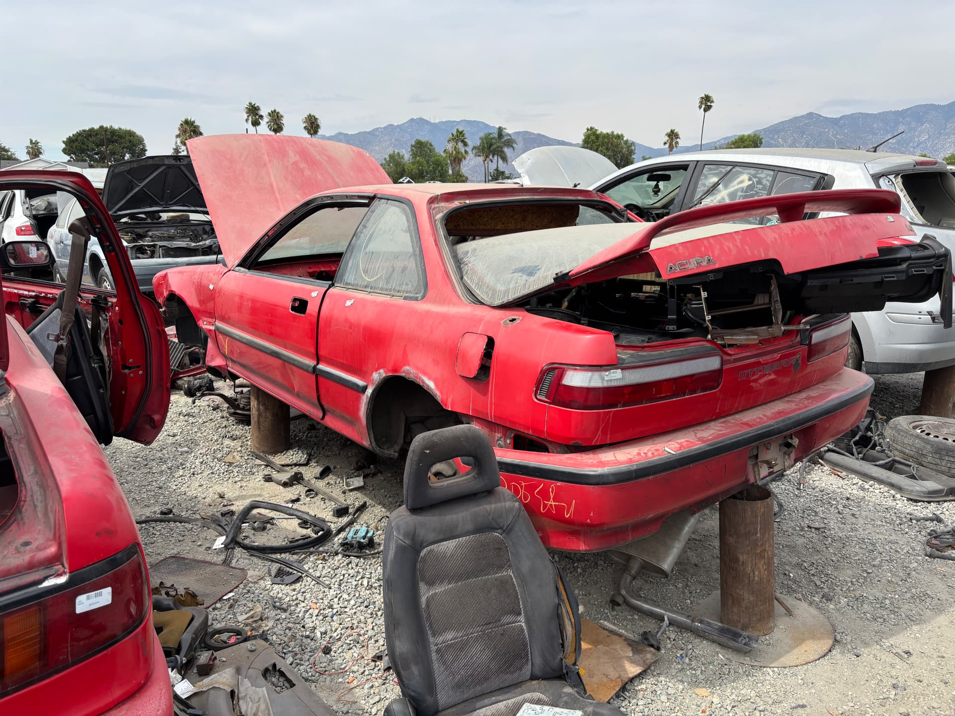

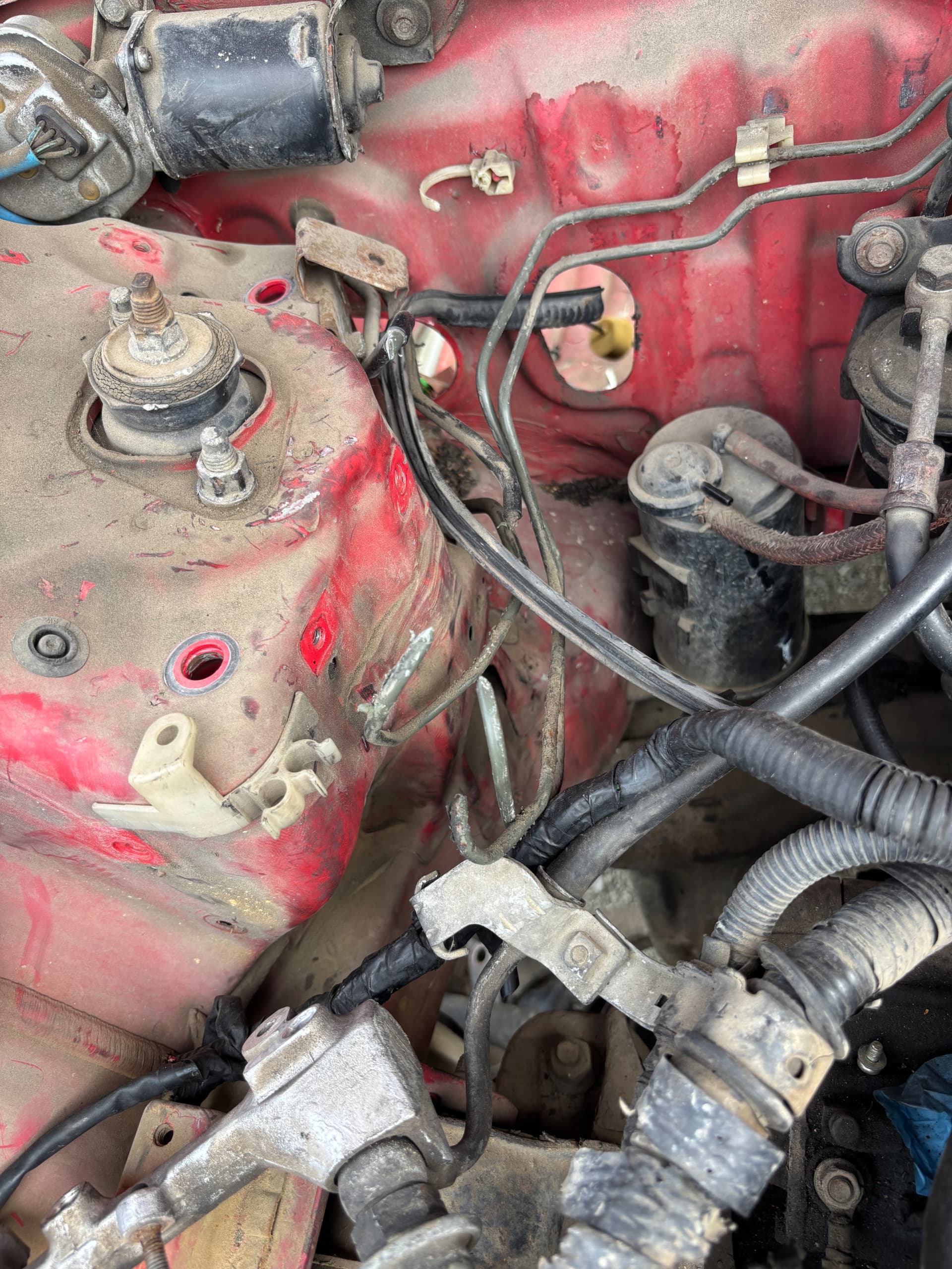

Went to the junk yard yesterday and saw two DA as donor car RIP you’ll be missed, seems like everyone cut and removed the 40/40 proportion brake valve.
I see that brake valve gone A LOT. And usually “hastily” :-/ Sad to see the cars get hacked though.
