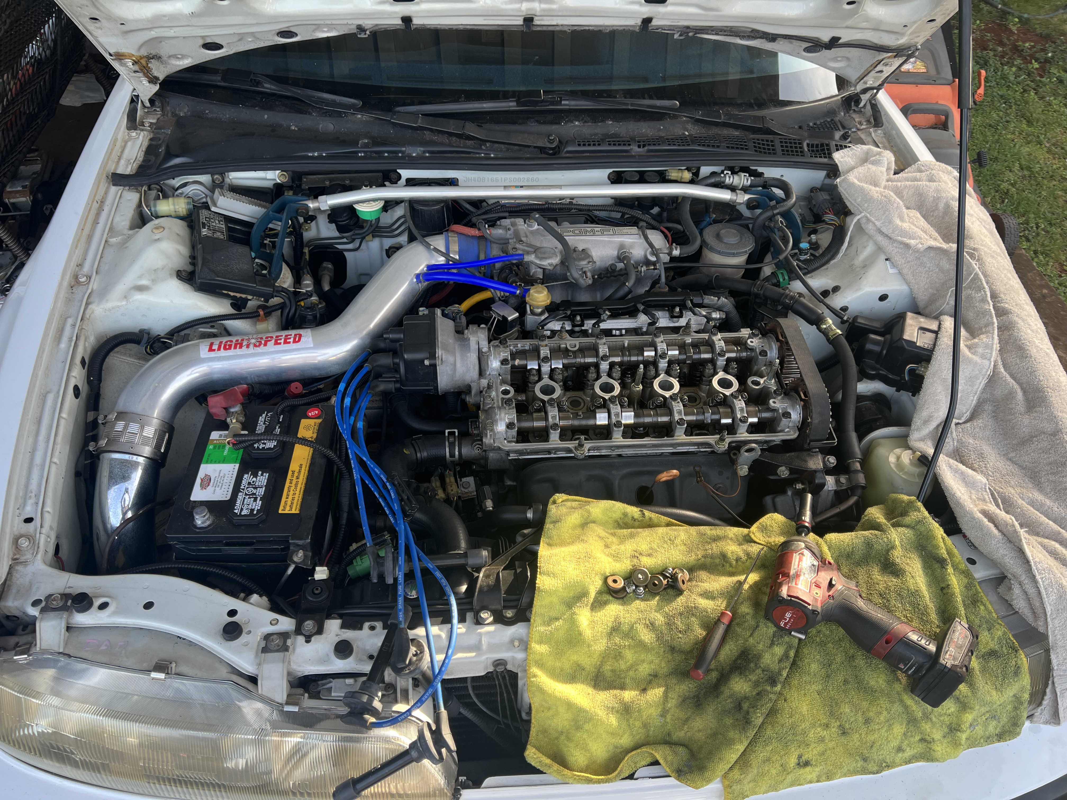

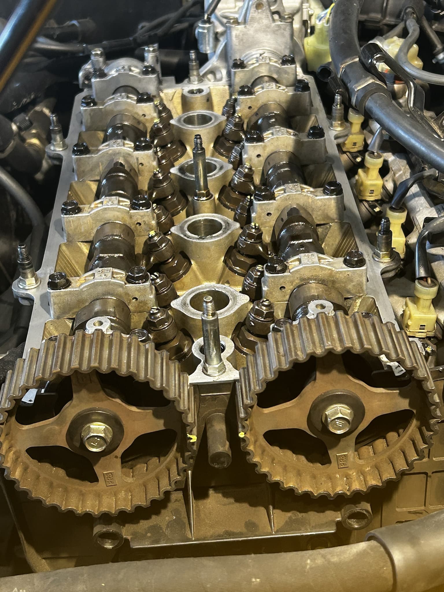

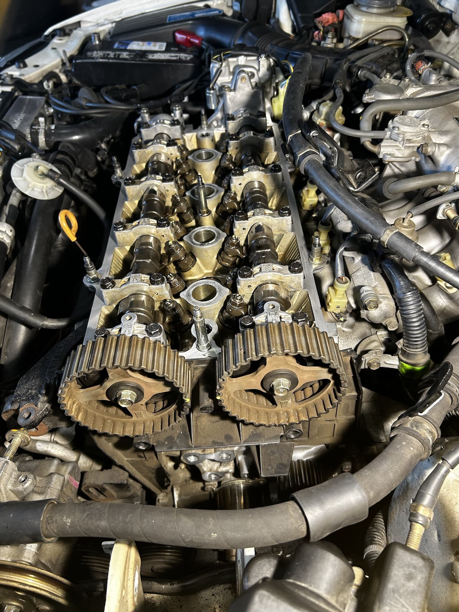

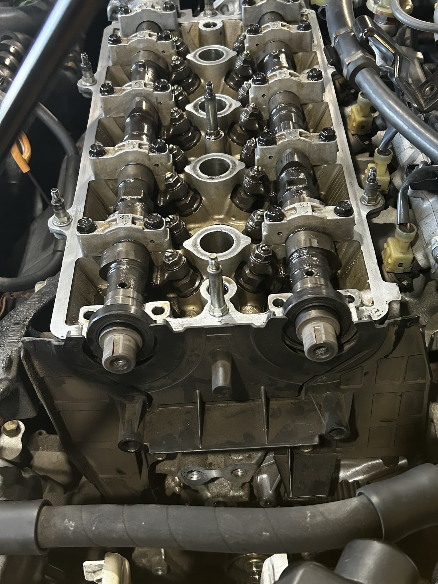

Currently doing my timing belt and water pump. I managed to source some OEM cam and crank seals too, so I replaced those also. Turns out this job was more necessary than I originally realized with the current water pump is actively leaking coolant, and I’m assuming that for the entirety of my ownership the timing has been off a tooth too causing an occasional misfire.

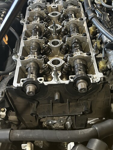

I had my timing belt, tensioner, water pump, shocks/coilovers replaced, new stainless steel brake lines, bled the brake fluid, brake pads on all 4 corners, new spark plugs & NGK wires, and new fuel pump put in last month… replacing the oil pump now… will replace the fuel sending unit next week. Hope to have her back on the road & legal by next month.

Yeah, when I replaced my oil pump, all the work done for my T-belt and water pump work had to be done again. Lining up the timing marks are important to avoid misfires. Be sure to clean off the oil on your spark plugs from the misfires.
