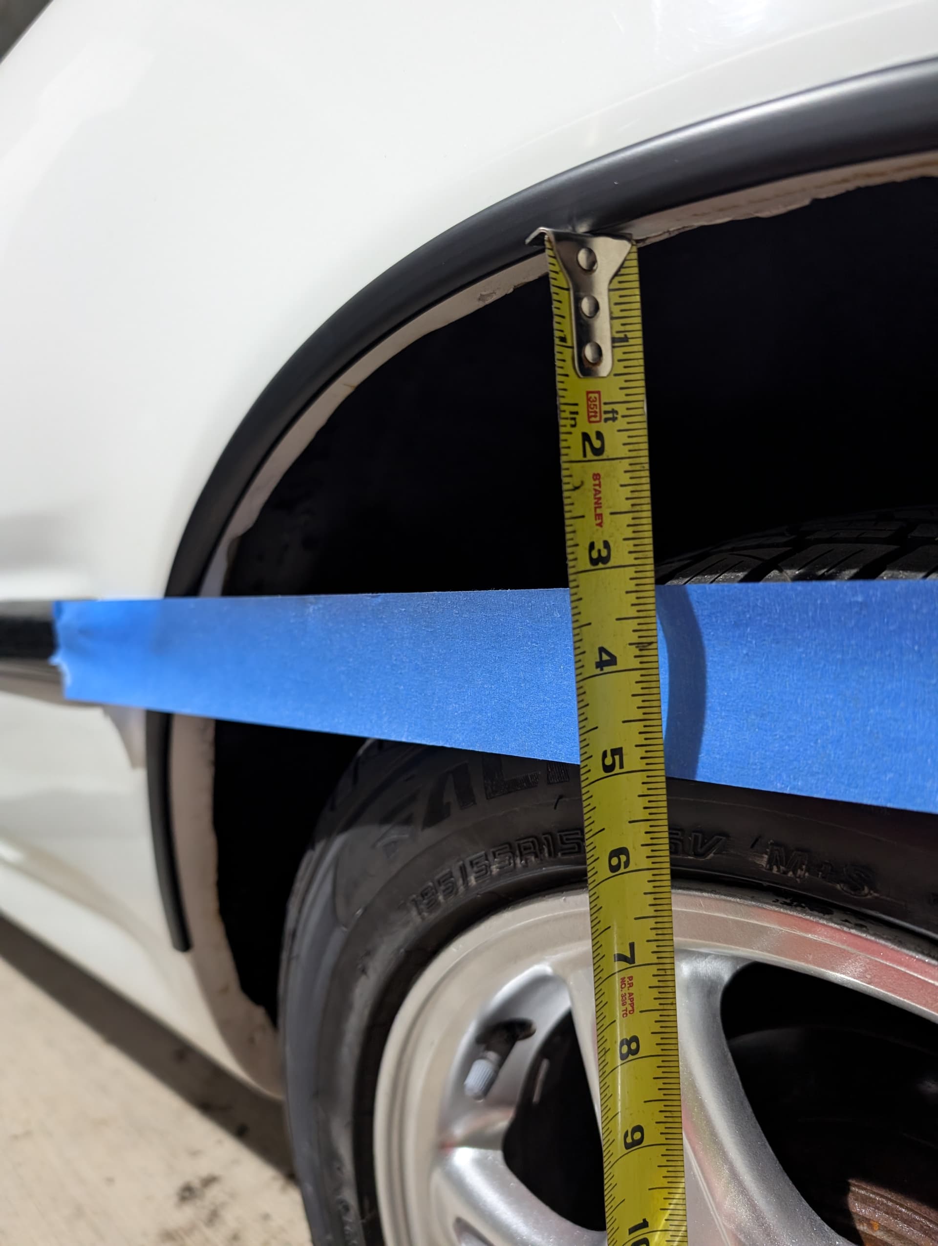

Also, I tried unloading my rear suspension bolts and re-tightening under load, but did not get the rear end any lower. Can someone run a string or a straight edge across the top of their trim and measure to the highest point in their rear wheel arch? I want to compare mine with an intact rear wheel arch.
Can you take a pic and draw a line regarding what measurement you need? I’m not following you.
Here you go- The blue line is the reference line across the trim, then I want to measure to the inside of the fender arch.
Got it. I’ll get back to you after work if someone else doesn’t get to it before me.
3.25in
Sweet thanks Neil.

Mine is actually the same so it’s just these lousy rear shocks I guess.
