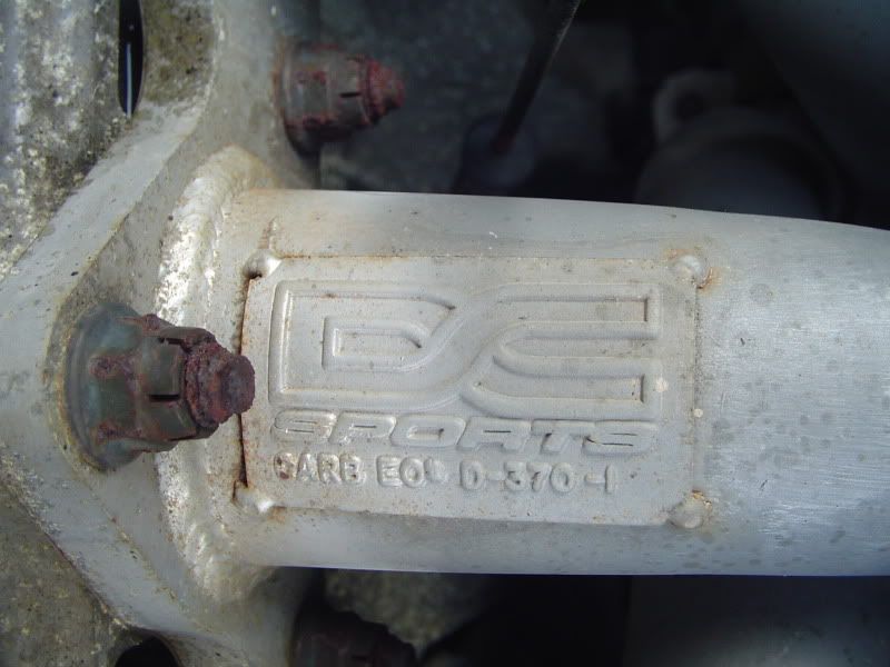

DC is a reputable company. I dont think they would make a header that would cause problems. Mine is carb legal, Is yours?

Also, I just looked at it and it had no carb badge on the header itself. I thought all DC headers were carb legal though. Not that I care, just wondering.

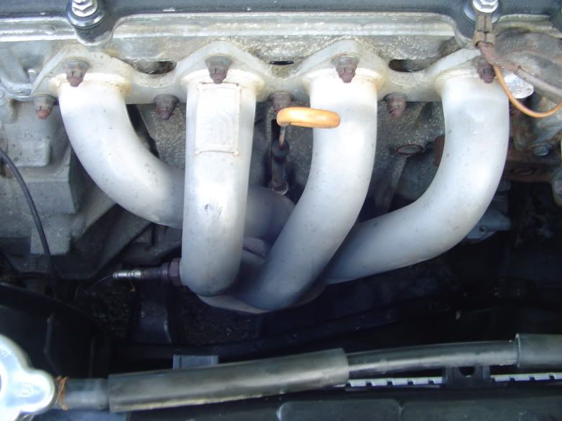

some pics of my header for proof.
Exactly how that picture is for all no name brands and dc header for the 90-91 header. O2 sensor is on runner 3 and only really catch emission of that.
I had a no name branded header with o2 sensor bung located exactly like this and when it was time for smog here in cali i didnt want to waste time and take off and put my stock header where all four runners meetup at the end.
Anyway with the header i still had a slight smell from my exhaust. Gone to smog and fail by few numbers and the guy told me put my stock back and come back and thats how i knew i passed.
So now i have a dc header with same bung located on 3rd runner but i screw it shut and extend the wire down to the collector where i made a new hole for it, and now it works as good as stock or better. Problem solved for me and i can bet anyone with a no name or dc header with o2 sensor bung on 3rd runner is going to have a richer smell on the exhaust regardless…
notice runner 2 is there but with all the pressure pushing out really runner 3rd is probably the only main one sensing it most. Probably not to a point where anyone would care much of a notice, but if u are about emission,gas proper mix air fuel etc or be as close to factory setting then EXTEND wire down with new hole in collector in replacement for o2 sensor if using aftermarket headers.
