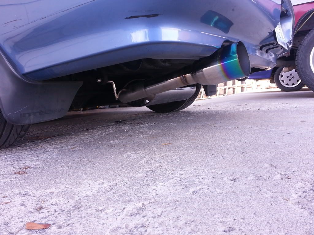

Do not confuse this cat back with the other “ebay kits” out there, there are only 4 different “colors” for this kit, all the same as far as construction. There’s others out there that da6xsi06 mentioned that will sit really low and fitment is bad, they are the ones with the round mufflers.

I like how it fits, not too low and nice n snug. There’s been times that I’ve gone over high speed bumps kringing thinking I was going to scrap and nada.
In the first pic you can see how I made the muffler shop weld the spun style cat to the test pipe, take notice to the non polish stainless piece they had to weld to extend it to fit, I wanted them to extend at the test pipe and not cut a new cat back.

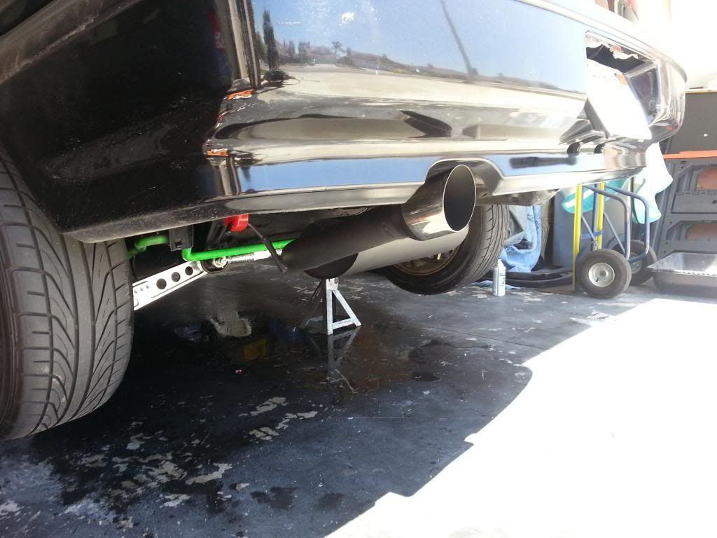

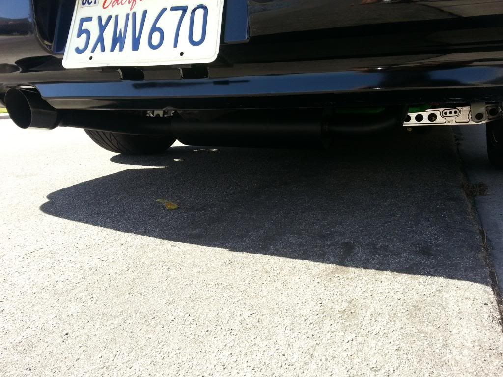

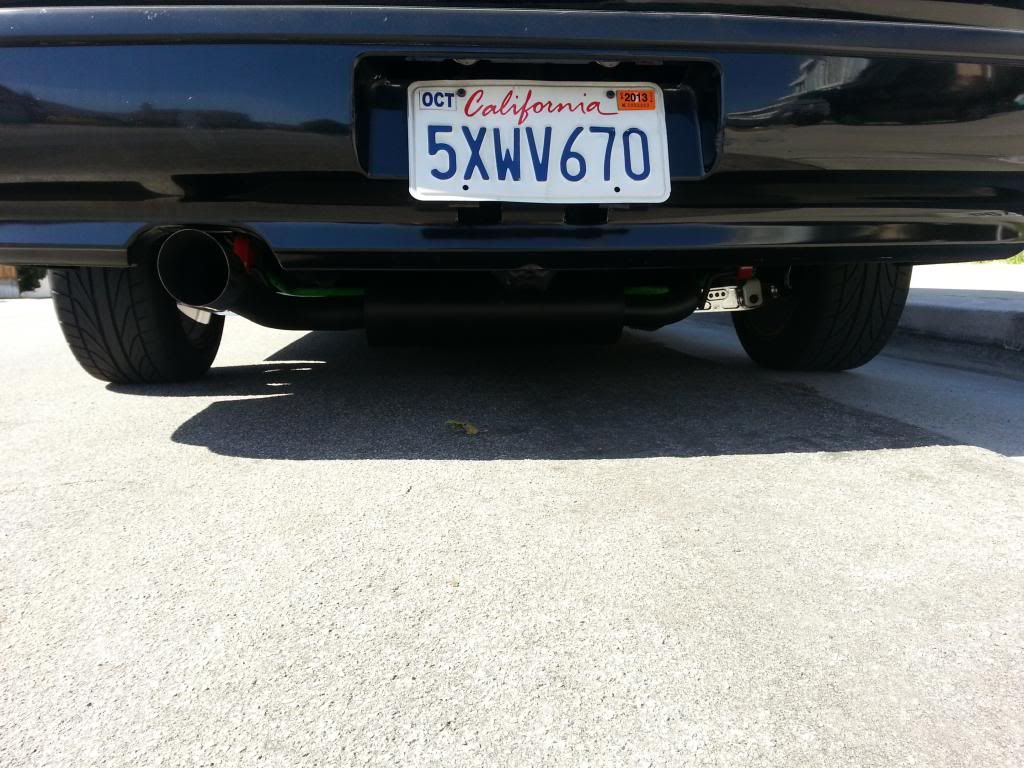

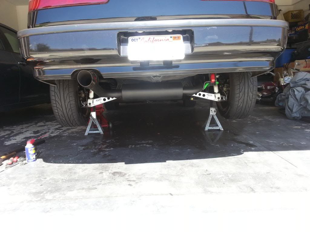

Ok so i picked one up in black so far its been ok i made some changes and have to go back to the muffler shop. Integ21 my tip stuck out way more then yours i have a 93 i dont no if its because its made for the 91 but yours is a 92-93 and it dosent stick out as much. I used some poly hanger bushings which i kinda regret now cause i had to move the hangers back. Ill post pics and my details when im done this week
ok so got it all done changed the tip and had the arm heated and pushed up some, it did not sit flush with the bumper from the smaller tip i used. Iam happy with it looking stock and being black looks stealth. Id say it sounds more deep then my old greddy and is just as loud at wot. I used the red poly bushings only in the rear to keep it tight and in place and rubber ones on the b pipe section, since the poly ones added a vibration rattle i could feel and hear in the car. Hope this helps anyone trying somthing different.
s2k arms and rear lower bar st rear sway bar and some red polyurethane hanger bushings is whats underneath
