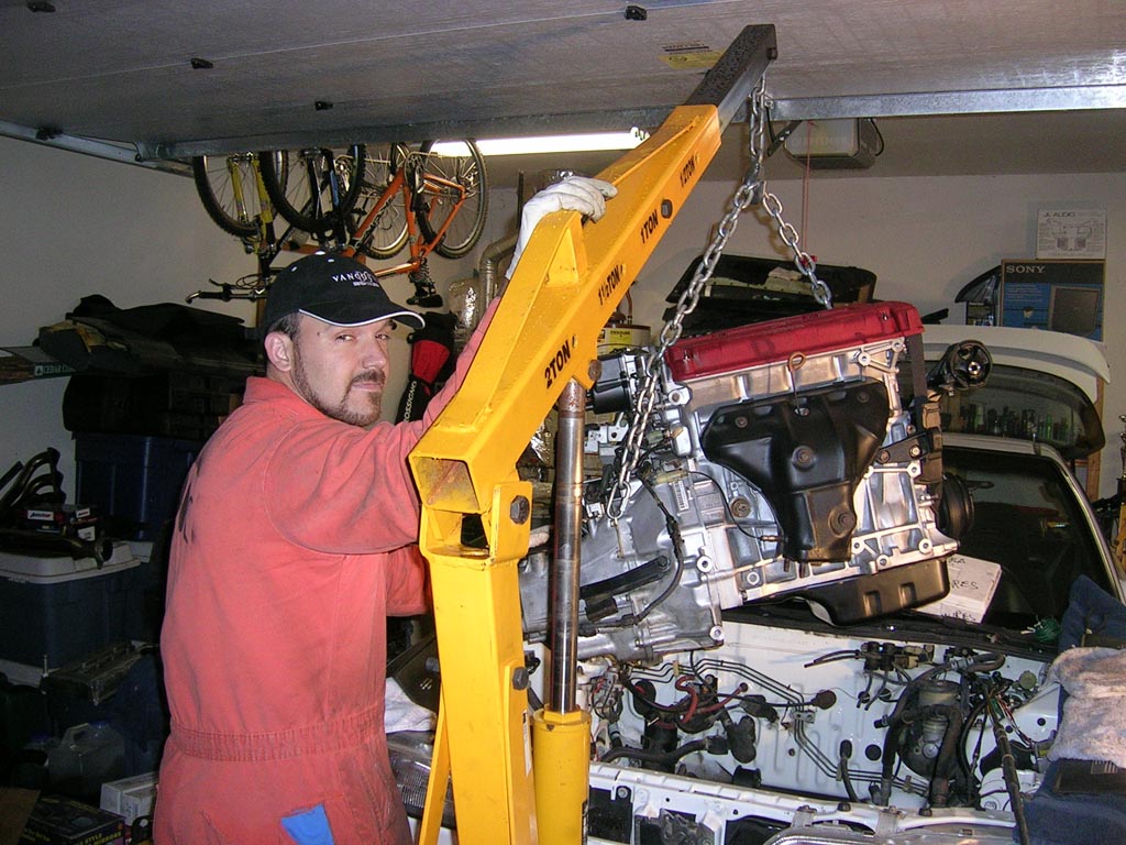

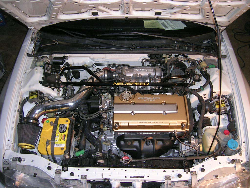

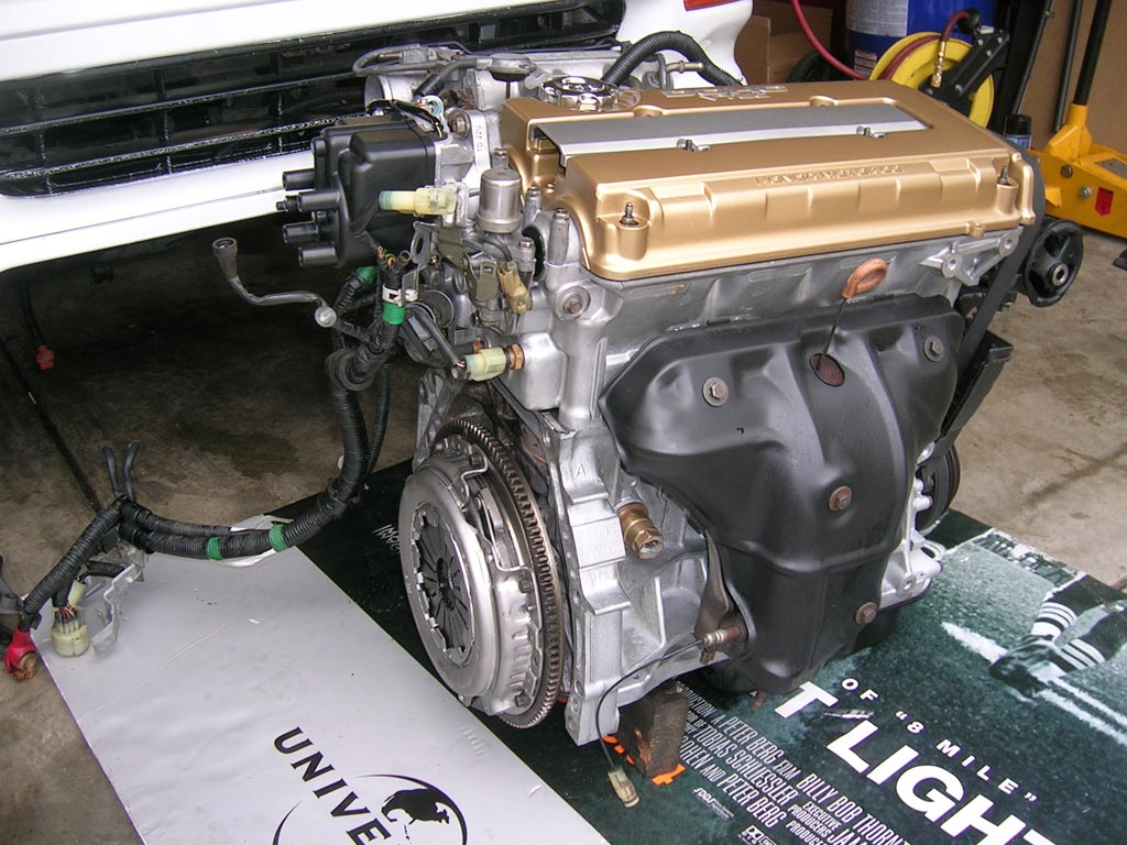

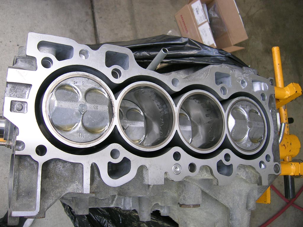

I recently helped a friend build up his B17A that we dropped into his 91 Teg. If he wants to come forward and share his name, it’s up to him. but here’s the list of mods…
ACL Bearings
.025 over PCT pistons (CTR)
Cometic .045" thick head gasket
RC 270cc Injectors
J’s Racing Program PR3 ECU
Apexi V-AFC
CTR Valve Train and Cams
B&M Commandflo Fuel Pressure Regulator & Gauge
13.5lb lightened and balanced stock flywheel
Exedy Clutch
I think there are more mods but can’t remember. Here are a few pictures…
Where’d you get that funny block drain plug?
Good job on the thicker cometic. I’m going to put an .060" on my CTR powered B17a soon. California’s 91 octane isn’t cutting the mustard.
The block drain is actually a block heater. Used for colder climates that you Cali guys don’t have to worry about. hehehe.
No wonder I’ve never seen one
