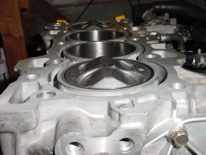

Actually, PCT pistons fit fine on B18C rods. Just know with the PCT pistons your compression will be closer to 12.6:1. The C-speed calculator doesn’t account for the .025" taller dome height of the PCT piston which instead of giving you .026" Piston to deck height (in the hole) with standard Type R pistons, you’ll be about -.006" out of the hole after decking the block. We just did this install on my brother’s Civic. We ended up using the Cometic .040" Head gasket to drop the compression to near 12:1. Here’s a shot of the pistons in the block.
Good post Dan. A lot of people are mis-informed about piston to deck height with CTR pistons because of cspeed’s site.
