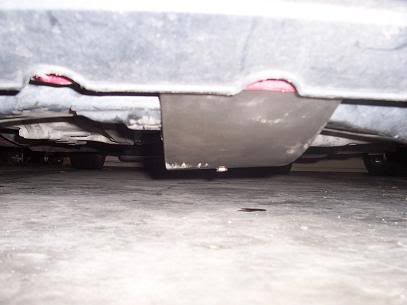

it will fit just fine. and the notch in the crossmember is very minor. the type R headers are the ones that will hang low on a g2. i made a skidplate to protect my 98spec itr header. itr headers are also short, so the exhaust will have to be lengthened. the two piece headers will fit much easier, and shouldnt need any extra clearance via cutting the xmember.
