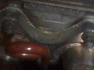

What kind of intake manifold is on that head? Is it taller than your LS manifold, or is it about the same size? Does it have a silver box on top the manifold, or maybe a big hole @ the top of it? If so, that’s surely a high compression B20 head. Look @ the round circles w/ slashes through them
above the header.
These:
All you should care about are the first circle from the left. If the number on the first circle is either 0/0 0/1 it’s a 2000 or 2001 B20 for sure. If the number on the first cirlcle is 9/9 then look at the second circle. It should be
1/1 or 1/2, meaning it was made in Nov. or Dec. of 1999. As you should know, this is because Honda starts making new model year cars early. If it says 9/9 & the second circle says either 1/1 or 1/2, it’s a 2000 B20.
Keep the head & get a B20 block. Put all your parts in/on the B20 & get it tuned well. That car will kick some ass & be fun to drive too. Look @ this:
