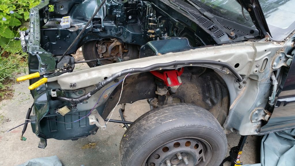

What’s up g2ic. Progress has been slow but it’s because I’ve been trying to get my daily sorted. Cars been on the back burner for a minute now but come fall/winter the engine will be fully going together.
As for now I just finished looming the rest of the in bay portions of the main harness. It was dark so sorry for the bad pics and dirty car
Before
After
Finished shimming the 4 way valve and the loop
