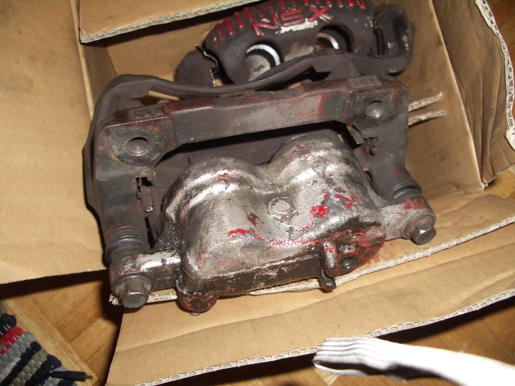

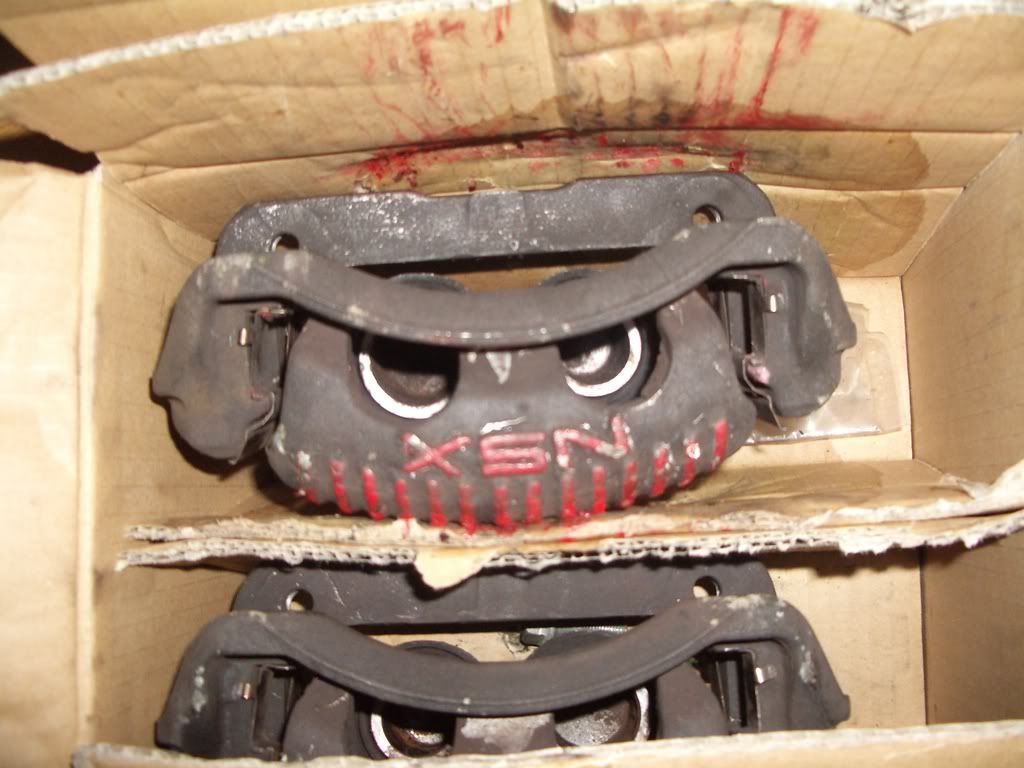

I’m wondering if these are the correct caliper brackets I need for the NSX caliper swap.
Guy I bought them off of had them installed on his EK hatch.

As long as the bracket says 23T, 25T, or 28T, I think you should be good. I’m using the 25T brackets on my set-up, and I’ve heard of others using 23T brackets, so you’ll just have to grind accordingly. Those are NA1 calipers you have right?
Yes, NA1 93 model IIRC.
Where is this T28 or what have you stamped?
top right on this caliper, maybe?
looks like 25t upside down

The stamping is on the bracket, and yea those are the 25T brackets. I went about it kind of ghetto, since I had to have my car back together. But I used a 4" grinder, and ground down the inside of the of the bracket (25T) so it would clear the rotor, you’ll see if you bolt up the rotor and then the bracket. The proper/cleaner way would be to get it milled though (you can choose to do the outside of the bracket, but it’s much more critical that it’s straight since it’s a mating surface.)
