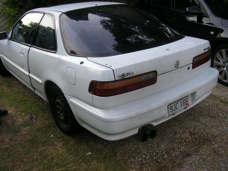

when i’m driving the car, and this is being normal, and i let it get to about 4k, or a little over 4k the car will pop, and i noticed that i can do it in almost all the gears. Should i be worried or ??? i’m thinking it’s the exhaust that’s on the car.
i’m going to replace it so don’t worry… i hate the way it sounds… but i want to fix all the major shit first… i’ll post up pics of the entire car here soon so you guys can look at the work in progress (believe me when i saw that) and yes i’m running rich… the back of my car is black now… i asked this guy i know what it could be and he said he could be some sort of switch that turns on when you start it up and is suppose to close something so it won’t run rich… (if that made sense, i can’t remember how he said it.)
