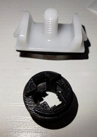

I did a test fit, unfortunately the little arms do NOT grab the center bolt that’s already on the car. I’m off by 1mm. Will need to adjust the model, reprint, and try again.

Printed twice, both adjusted. Still won’t grab and seal. I think it is to do with the dry-rot of the already-old cowl grommet on which the cover screws attaches.
I’m going to purchase a NEW cowl grommet and then make a 2-set piece that will work together.

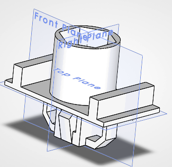

The part arrived, and I test-fitted my current design’s screw on it and it’s NOT fitting at all. The little tabs won’t engage properly with the screw, so I’m going to keep the outer surfaces and redesign that mating/tapped surface. What I’m worried about though is that movement that is needed on the screw part, because that gets adjusted on the fly when fastening the cowl. It’ll take some effort for sure.
I’ve begun a totally new design on this, but it needs some work on making sure I get the torque forces properly handled. Pics probably this weekend.

I had some family come into town unexpectedly and it threw off my plans. I did complete the design of a new screw. I hope to print it today.

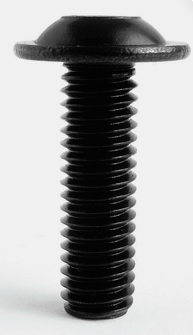

Printed. I need to find an M6 screw to check the threads.

This is the current cowl mount “bolt” with the screw cover that holds the cowl down.
I’ve been unsuccessful with getting the two to mate properly.
So here’s my idea. Recreating the bolt but allowing a spot for a metal hex sleeve to fit inside.
A sleeve like these:
And then a flanged bolt with a nylon washer (perhaps) to secure the cowl down.
I will then make a cover that fits into that flange bolt so it mates with the outer surface of the cowl.
