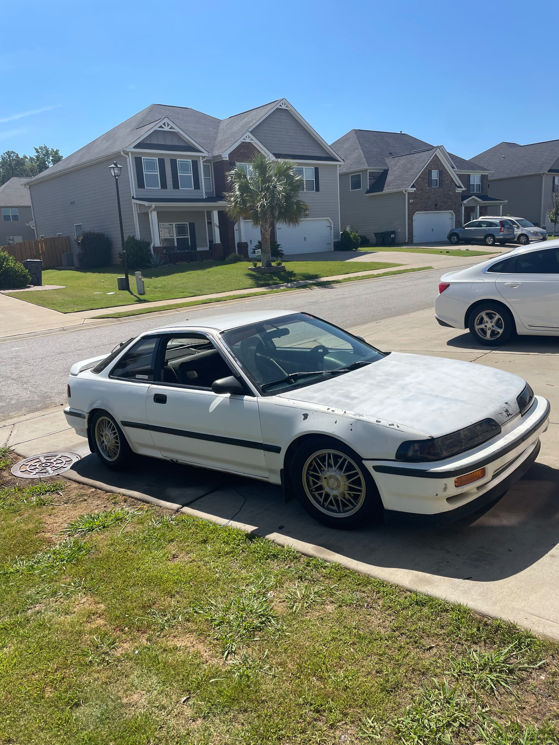

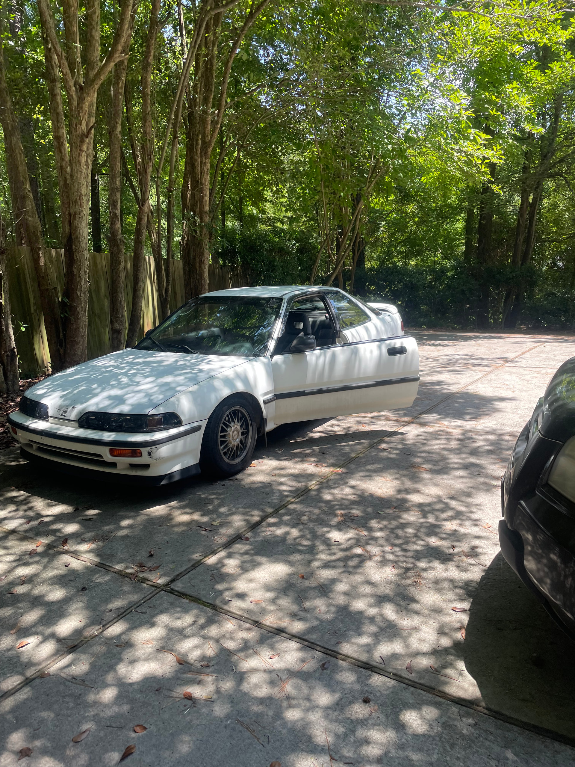

Check you out rocking those GTS covers!
not going to lie I have no idea what those are. I got the car thinking it was a Honda accord and as something better on gas that’s manual for school. turn out a lot of people like the car and its something pretty cool so if there is anything y’all see that’s different please let me know.
If you post more detailed pix inside, outside, and engine, we’ll be happy to tell you what you have.
On second look, I think what you actually have are the black housing aftermarket headlights. Have you noticed whether the light output onto the road at night is poor?
I’ve actually have been told there pretty bright but that’s probably just the bulbs in them. they are white when they are on and have yellow running lights on the inside when I turn them off. I will post some pics of it thank yall.

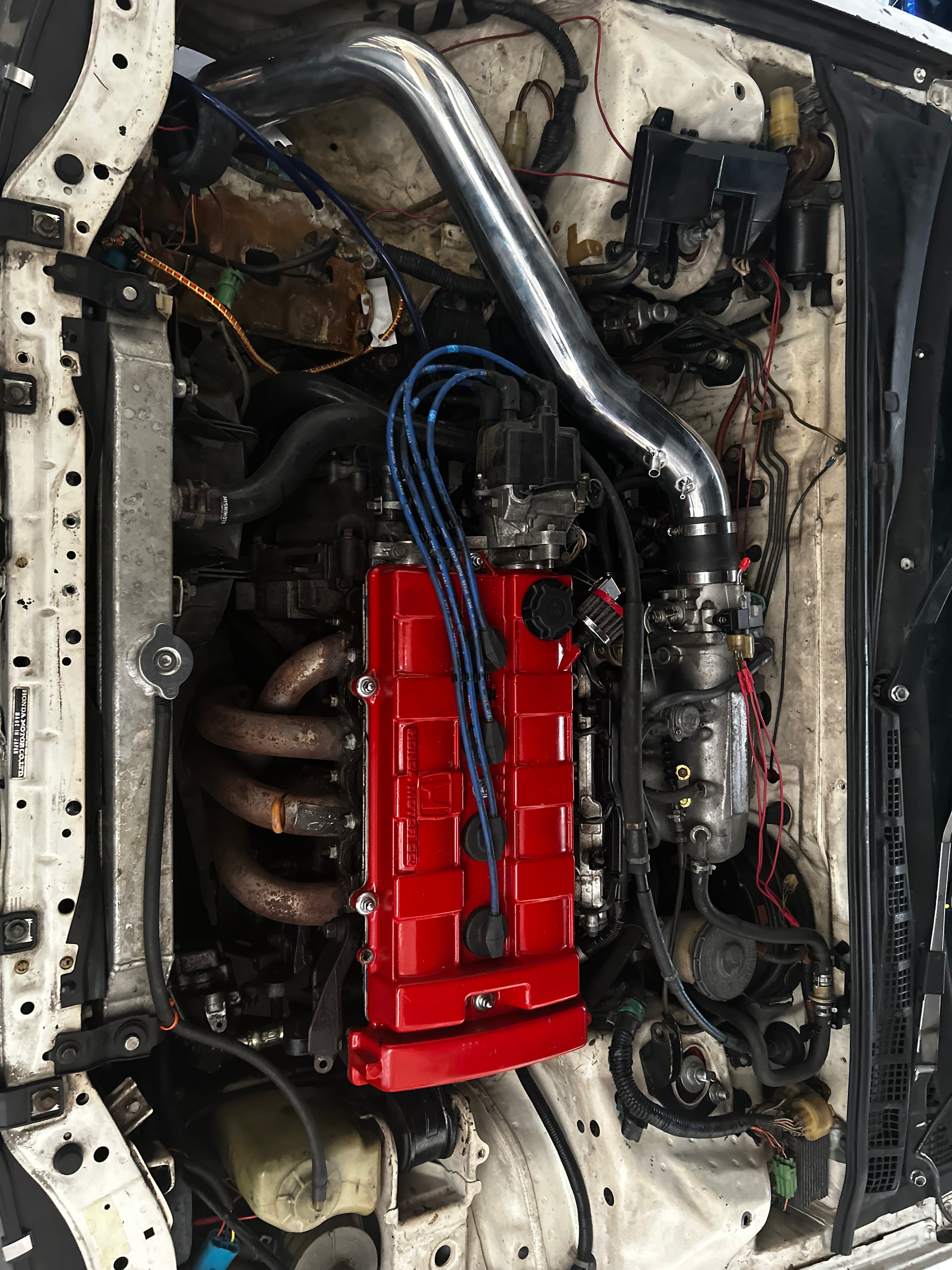

Hm what are those red wires on your throttle body?

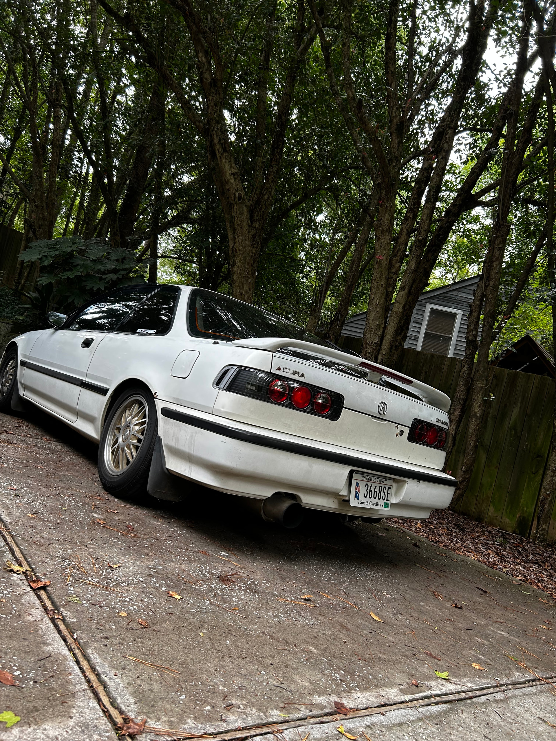

Is your battery relocated to the trunk?

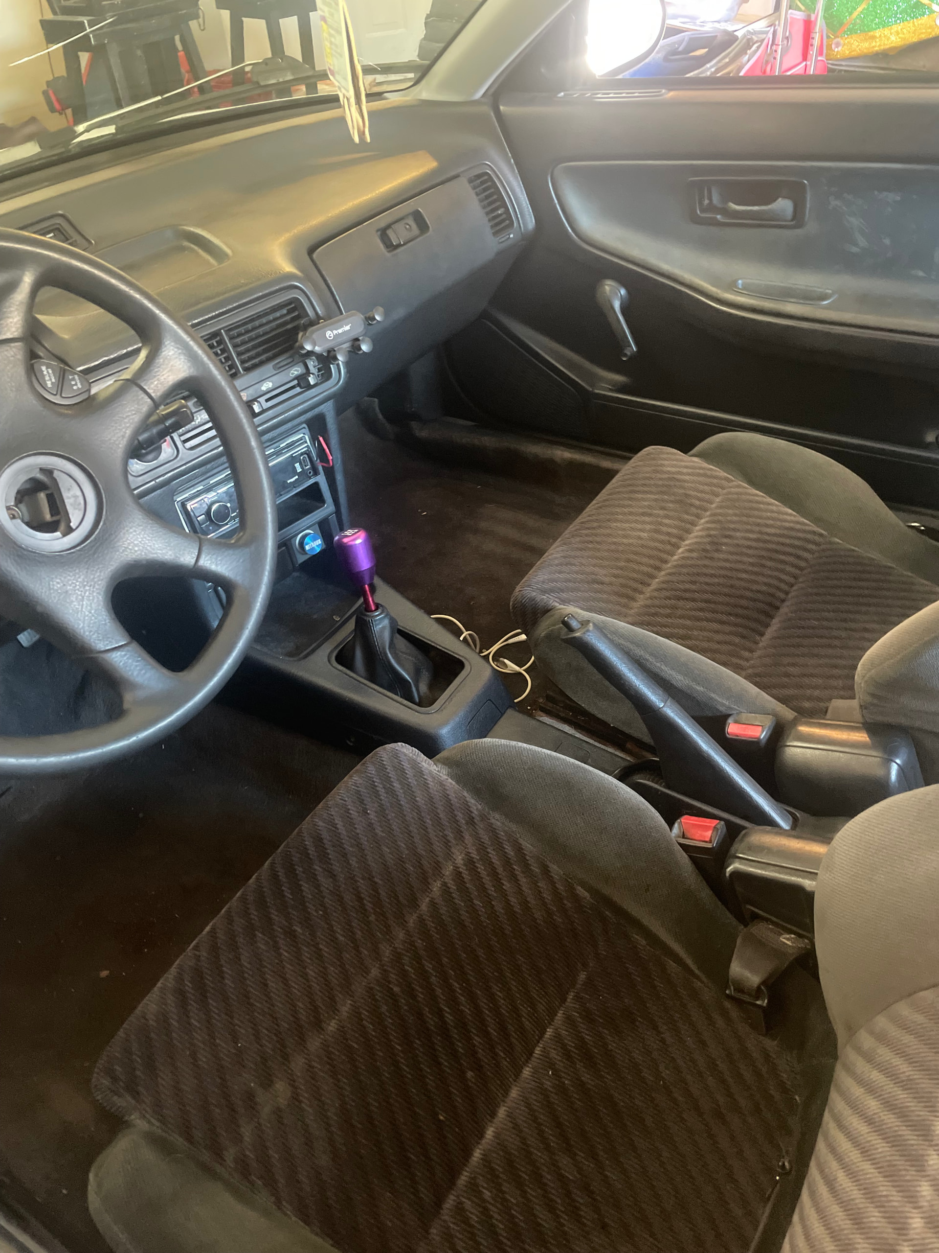

Do you need a steering wheel center cap? I was thinking about modeling those.
Looks like the Throtle position sensor is rewired. MFR for sure will kill a car mid drive.
