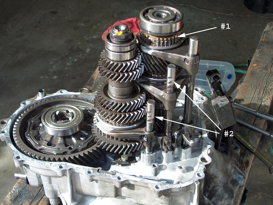

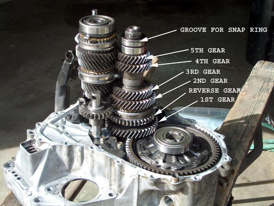

whew finally got the cover off. oddly everything moves when i turn the input shaft, but of course when it was in the car no gear engaged. pp/clutch/bearing looked ok… gears look ok also except the reverse one looks kinda chewed up.
anyways, before i start checking clearances i want to understand how shifting works. if its not asking too much, would someone mind explaining how shifting works from the shift rod to the internals? heres a pic from autozone (86-89integra transaxle):

well heres some pics of the tranny. anyone spot anything out of the ordinary besides the chewed up reverse? i cant even tell what gear its in…
remember you can add .orig.jpg to the end of the pic for the larger version, or just go to the album
heres the full album http://www.imagestation.com/album/?id=4291732619&p=4215401156&idx=82
oh and the clutch and pp. everything looks ok. throwout bearing too.

found a good link with some basic pics of a ys1 apart Messing with a Honda transmission
