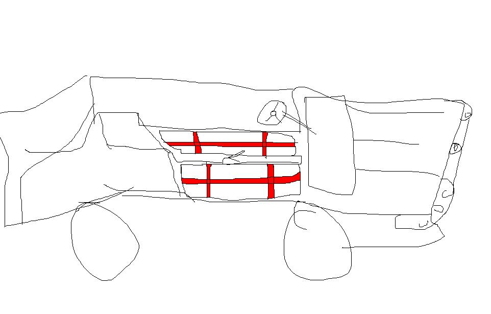

okay so i started workin on it 2 daiii … soo i cut out the floor well… started… anywaus… so the floor ahd been prefiously coated with sumkind of ashfalt sealer or sumttn… but what i was thinking is to put braces and metal on top …
theres a pic attatched of what i plan to do after these braces they are in the colour red … i will put medal on taop and weld it on … i will attatch pictures of this project step by step… let me noe what u think of the idea
i think your photoshop skills are 1337!!!111
thatz not the point man

Holy shit thats photoshopped? I thought it was the actual car. Well done indeed!

stop making fun of ma drawing lol
