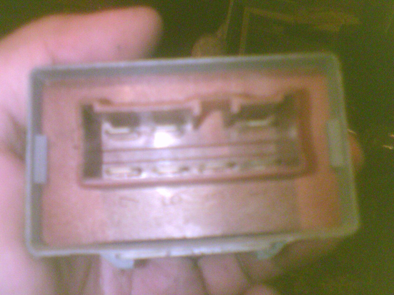

i have a main fuel relay and tried plugging it in but the connector that is missing a module har more prongs in it than the relay

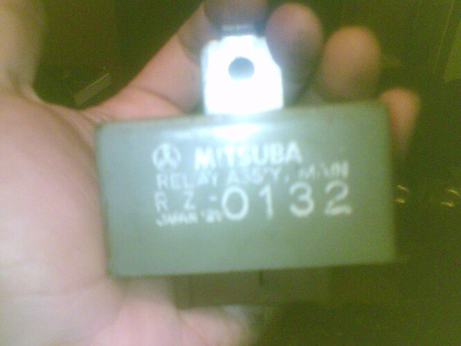

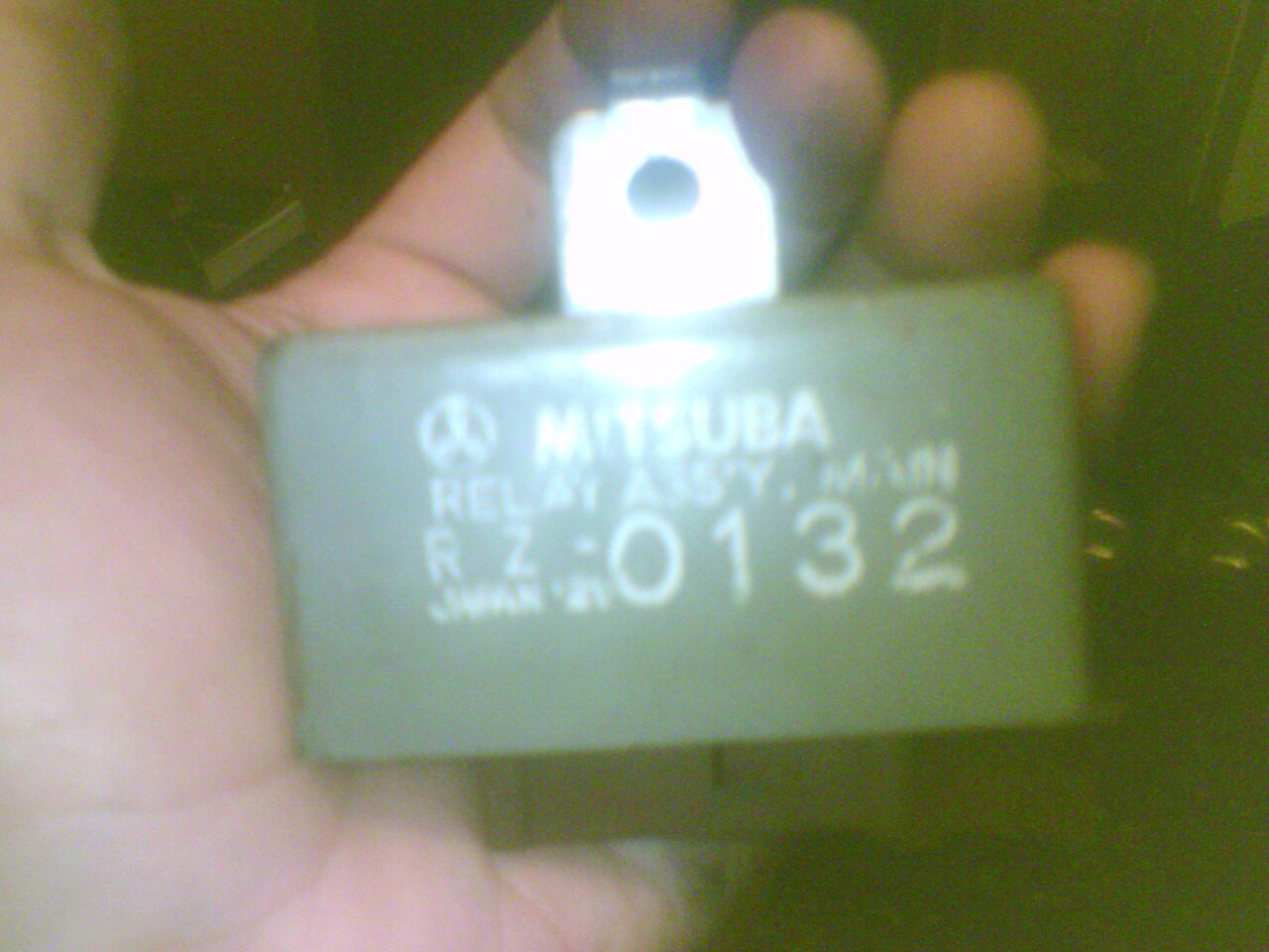

look at the relay i bought a while back!
i guess it is for some other honda? can i even use this?
You need a RZ-0063… http://cgi.ebay.com/ebaymotors/1990-1993-ACURA-INTEGRA-PGMFI-MAIN-RELAY-NEW-OEM_W0QQcmdZViewItemQQcategoryZ46101QQihZ005QQitemZ150129901205QQrdZ1QQsspagenameZWDVW#ebayphotohosting :hmm: 94
i found two relays. a 0067 which looks like the one my rs has and a 0063 which is black. they both allowed for my car to start so i guess they work. i’ll take your advice and stick with the 0063. thanks for your patience and sorry for the runaround. :smiley:
