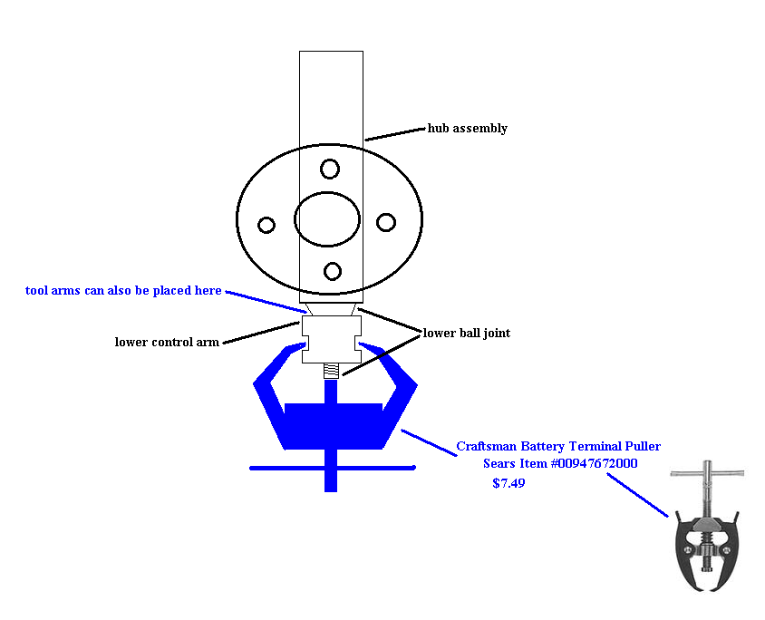

For a few years now I’ve been looking for an easy way to separate the ball joints on our cars without having to buy an expensive tool. It seemed that every time I had to separate the ball joints I was either tearing the ball joint boots with the pickle fork and hammer method, or whacking (and destroying) the threads on the ball joint with the hammer when attempting to use the sledge hammer on the lower control arm method. So after countless ball joint boots and 1 or 2 ball joints I have finally found the answer…
Using this tool:
Craftsman Battery Terminal Puller
Sears Item #00947672000
$7.49
Place the arms of the tool on the lower control arm where the indentation is just above the ball joint threads. If anyone has attempted the sledge hammer/lower control arm method of seperation the indentations may not work because the the flares may be bashed off or flatend. If this is the case you can place the tool arms on top of the lower control arm, between the lower control arm and ball joint boot. Once you get the tool in place start cranking on the handle so that the shaft goes up. After a few turns the ball joint will separate from the lower control arm!!! No broken boots or anything!!!
Here is an illustration:
Now go forth a separate ball joints!!!

Damn Dave, you must REALLY like that new tool to go through the trouble of drawing up that diagram…
Looks pretty effective to me though. I usually use the hammer technique, but on occasion I bust out with a bearing puller.
Good find though, cost effective and practical.

In some cases, you may not be able to grip the LCA well enough with the clamps on those.

Haha … I have the same puller, and use the top of the control arm for the arms to pull on … works amazing, almost effortless! Good post!:clap:
