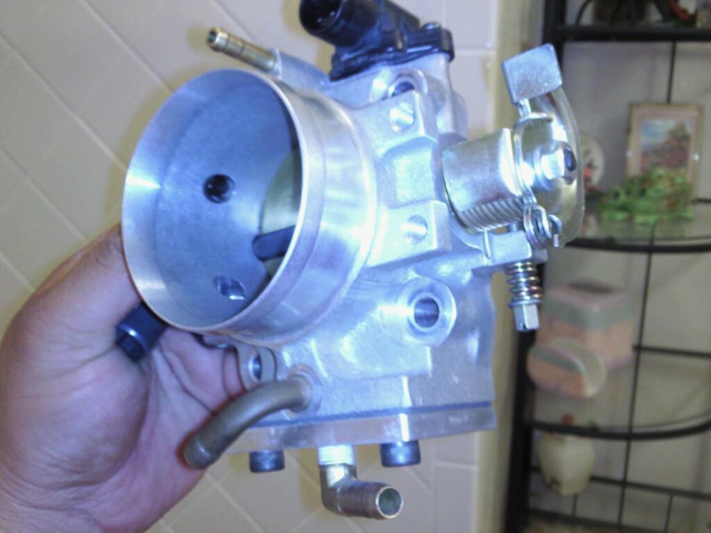

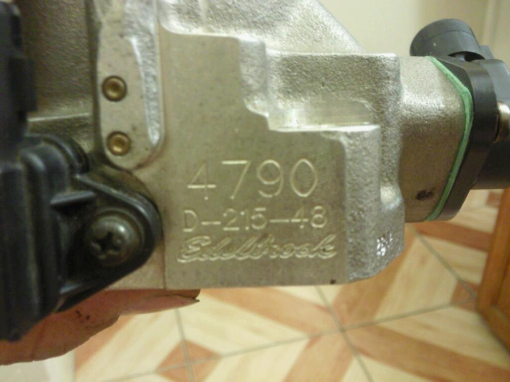

will a EDELBROCK 65MM THROTTLE BODY fit my 2000 b20b someone is selling me one for $140 bucks almost new but dont know if its to big for a stock b20b im running the b18a intake mani for now thats in till i find a skunk2 or blox intake for my 90 DA heres pictures of it.
if you’re going with the better intake mani then without a doubt run the 65mm TB. you may lose a little low end tq but you should notice it up top. but since its a b20 you should be disappointed in anyway
its for now as I’m building my ls with a v tec b16a head or gsr not to sure yet
