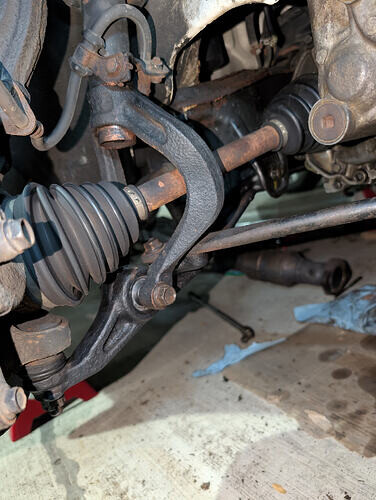

EF front lower control arm (LCA) bushings fit 90-93 Integra LCAs
Title says it all. Cross referencing part numbers proves the EF and DA shock bushing are the same but not for the inner bushing that connects to the subframe. So here they are, both inner and outer bushings successfully pressed in and installed. I went with Mugen because I’m a chump and I find it funny to say I have Mugen parts in this beater.
