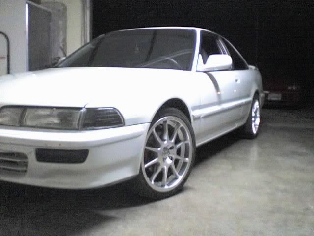

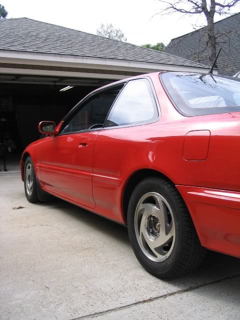

here it is lowered on pro kit. not too much of drastic drop.
pro kit on 17’s
Pro kit after accord lip kit
like i stated earlier, it not too much of a drop but since i have a one piece header and the roads here are rough its plenty of drop for me. can’t really speak for anyone that live in cali.
