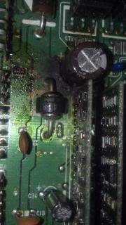

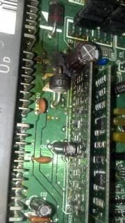

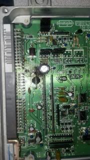

Here are some pics of the ECU.
Capacitors go out… If it was another part of the ECU that blew I’d be nervous of hooking another up… Not that you want to “throw an ecu” at it, but I’m thinking your wiring is fine.
I might try to re-solder a new cap on the ECU and see what happens
