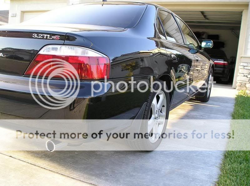

I bought a 2003 TL Type-S for the commute…
When i get the tokicos/H&R set up installed and the DB running properly it’s only going to be driven twice a week.

nice choice for a daily driver. Kinda funny how the two car’s resemble each other so much despite being like 10 years apart in age.
