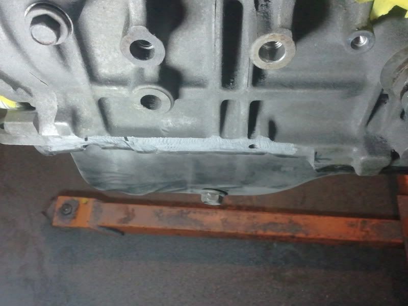

You have to shave the block from the back and use the s2000 single row pulley

heres where i shaved my h22a block for my h2b i was building

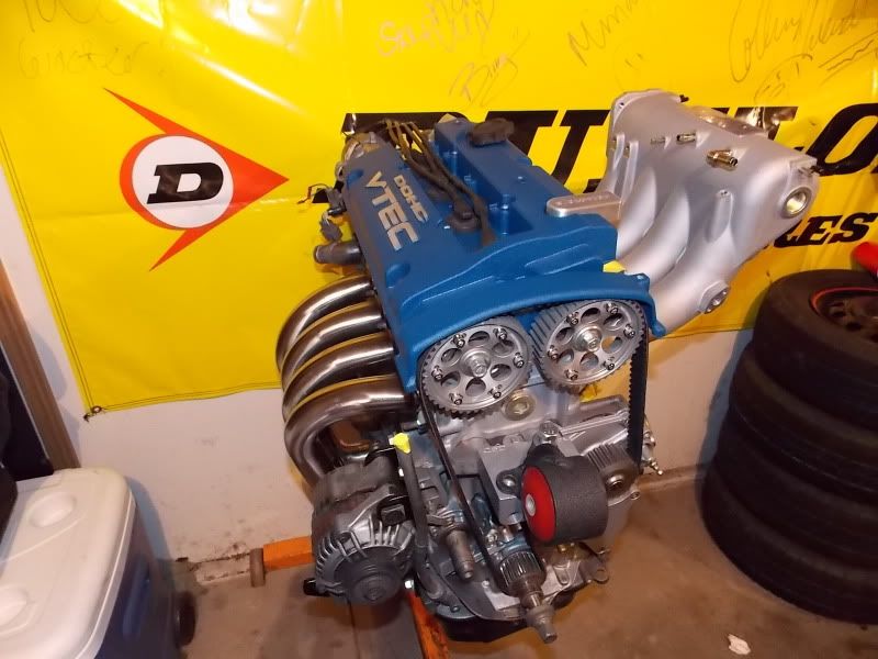

the motor…jdm h22a, stock block with skunk2 pro 1 cams/gears/intake mani, logic tri-y header, esp alt kit
race only?, qsd makes an oil pan just for h2b swaps so the oil is level, my friend dd his h2b hatch and didnt mind it at all and never had 1 problem…also it ran 11.8’s with just cams
