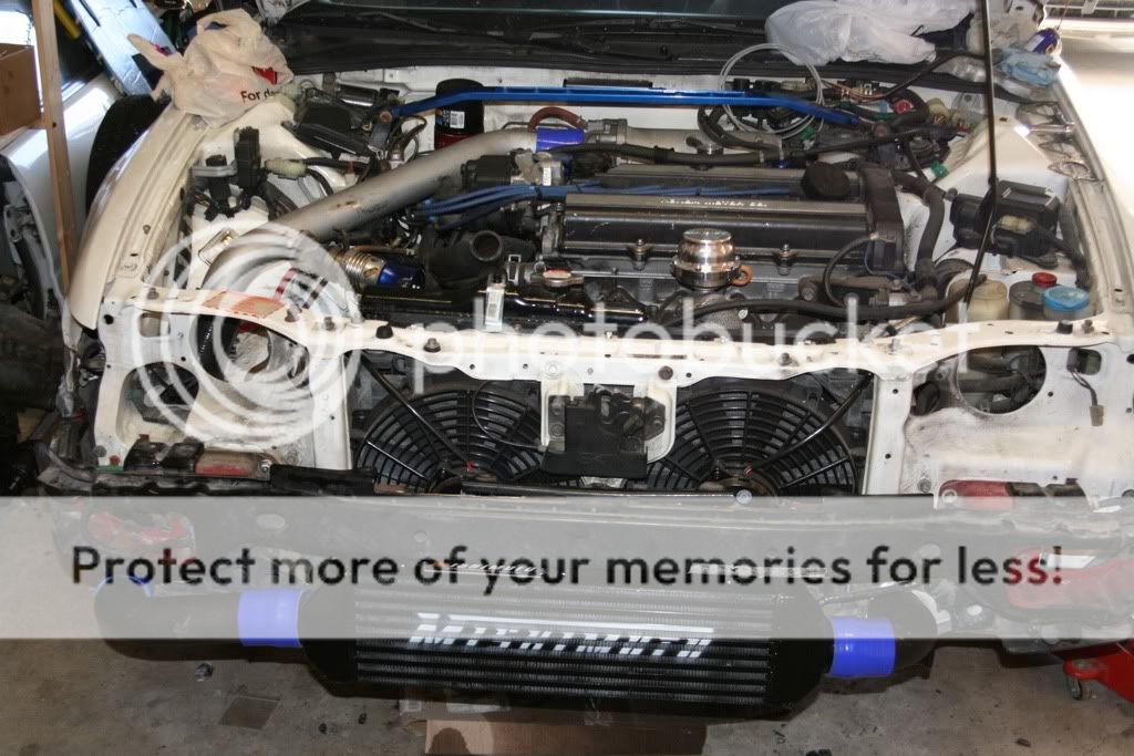

I just finished my turbo and managed to keep the AC. I ended up getting two slim fans (FAL) and mounted them in front of the A/C condenser and wired them for pusher fans instead of pull. The only problem I had with this setup was the fans interfered with the foglights. I ended up getting rid of the fogs.
