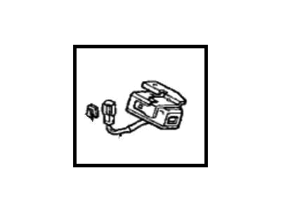

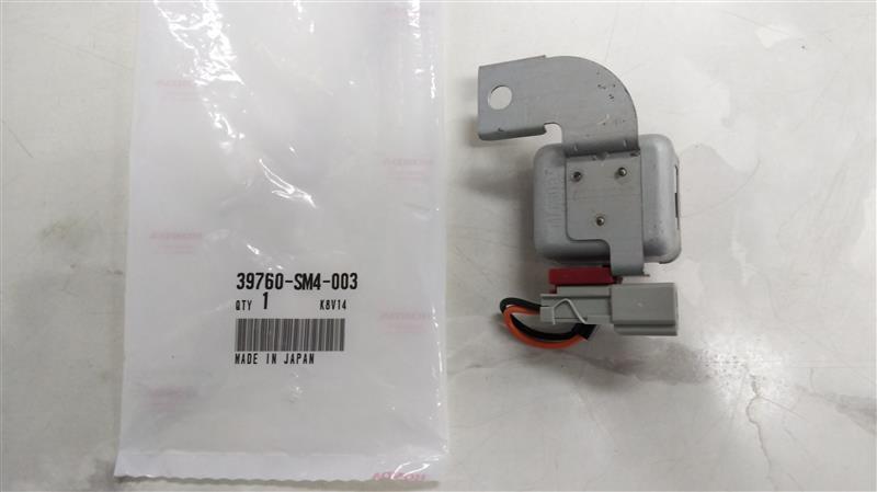

Is this what it looks like?
Wow I have NEVER looked this up for how long I have had this car. It is interesting though that a search for the name comes up empty on parts websites. :thinking:

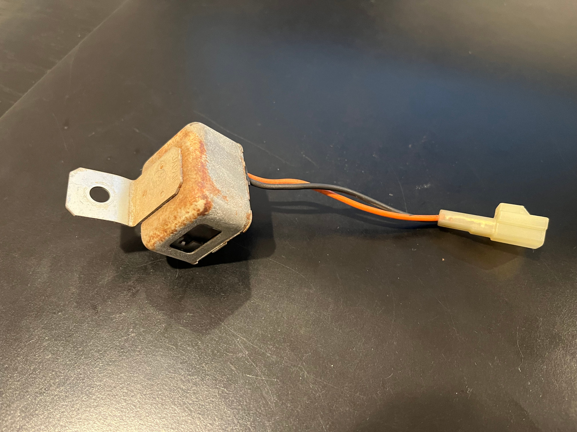

The one I found in a 92 in the junkyard looks a bit different. I would describe its location as; in the center console behind the ash tray. It is held in place with a single 10mm bolt. It requires a pulsing 12V signal, It chimes once each time 12V is applied.
I guess the ICU sends that pulsed 12V!
That would be my guess as well, so if you don’t here a chime it could be an issue with the ICU
BTW, please check your door switch if you’re seeing this not work. I don’t know why exactly you’re looking for this replacement. (I thought I’d post this here too).
