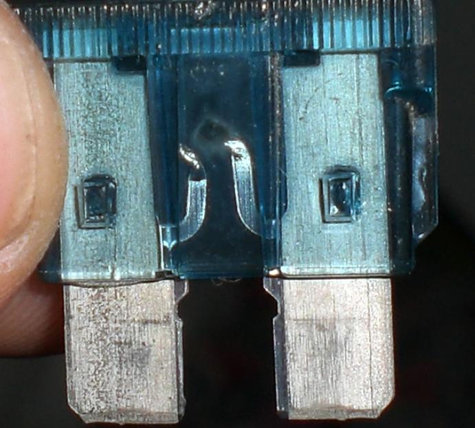

Do you still have the blown fuse?
How does it look, is the filament blown apart “explosively”, [melted filament ends, black residue, splattered specks] or is it a nice clean break in the filament?
It is possible the fuse was defective.:whisper: 94

Thanks for the quick reply. I attached a photo of my fuse. The blurry spots on the plastic where the fuse able link is broken are slightly black and burned.

Yea, that’s blown up real good, there must have been a short.
