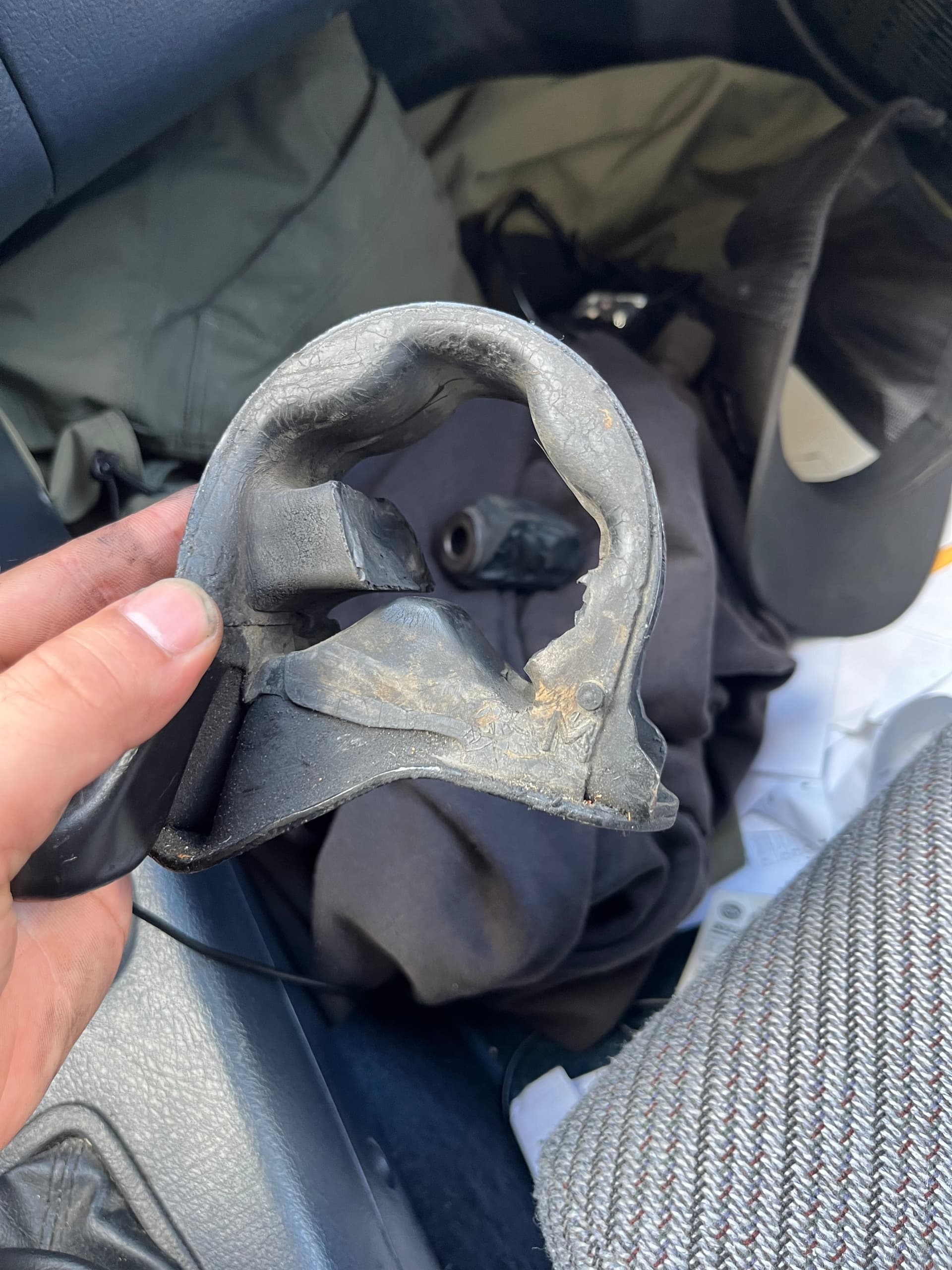

does anyone else have any experience with this? i replaced my front motor mount but the rear is also torn so now i think the good front mount is exaggerating the torn rear mount shakiness… i have the part and can do it at school on a lift. i can loosen three bolts from the top but i think the two in the rear have to be removed from underneath and i have even touched the 2 bolts on the bottom of the bracket
I can’t help, but I agree with the difficulty. I paid a shop to do that replacement for me. I couldn’t get my hands back there and even the mechanic said it was difficult but the full size lift really did help.
changed it with people at school and it is so much smoother when i shift.
it really helped to take the bolt out of the driver side motor mount out so you can move the engine and transmission around to get the mount in and out. probably couldve undone both side mounts but we did just 1
couldnt imagine doing it at home on the ground especially for the first time and by myself
Success! Yay! Yeah a previous poster above in this thread stated to remove one of the side mounts. I thought you had tried that ![]()
yes this thread helped because the guy recommended doing that.
