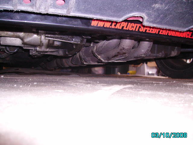

question iceman, are you still running the a/c in your car? can’t tell from the pic if the a/c compressor is still there.
id love to see a pic of ground clearance
any updates on this? im just waiting for the pictures in order to go buy mine!!! c’mon synsei or iceman, shed some light into this!
Haha. Alright guys. I’ll take a picture when I get off work tonight…unless somebody beats me to it.
clearance is the same as a JDM ITR Header for the most part. i’ll throw some pics up.
ok clearance understood, now how about the “general fitment issues” that you mentioned before, do we get to keep the AC, Power Steering, stuff like it, you know…gott stay comfort, yet powerful jejeje:angel:
Well yeah of course. Most headers generally keep those components, it’s turbo manifolds that oftentimes do not. There are a few very high end expensive headers that may take up more room, but im not totally familiar on that.
I’ll have some pics up tonite, I’ve been staying at my dad’s place last few days so I’ll be home later on and I’ll throw some up. There were a few fitament issues but for the most part they were fairly easy to fix.

Ok so here is the issue . . .
that’s my friend nick finishing up the headache. see the nice red exhaust bandage protecting the pipe from the u clamp? here’s the scoop. the head flange was tilted so that when bolted to the head, the collector was angled downward nearly 2 inches, meaning it wasn’t gonna line up without help. after much deliberation here was the solution. using the separate mounting bracket that came with the header, we welded on the ubolt flange and secured it to the existing stock mounting bracket (if you have installed a header before you know what i’m talking about. then we used exhaust bandage to “pad” the area where the ubolt would hold the header in place, and using a jack we “coaxed” the header into place. once it was where we wanted it, we bolted everything together and went on with our business. that was the ONLY hangup. to be honest it wasn’t that big a deal, we just were trying to find the simplest solution possible.
as you can see, it fits very much like a JDM ITR header, albiet the formation of the secondaries and collector is slightly different, the primaries being so long, make it clear about the same.
